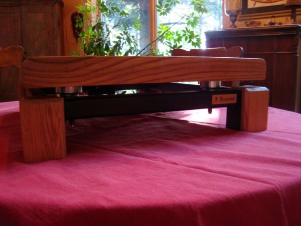

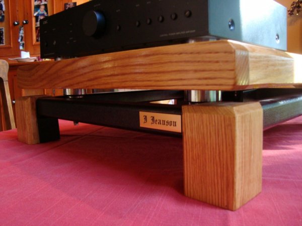

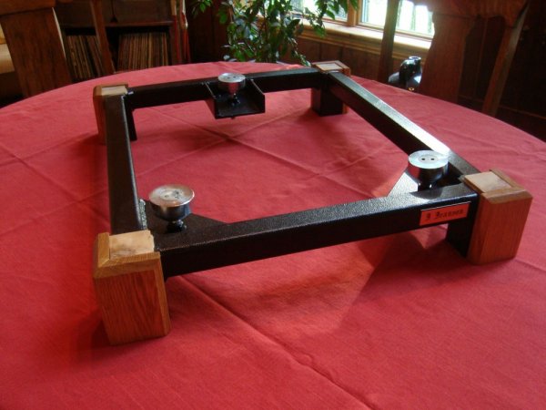

DIY racks for Krell KRS-100 mono blocks.
