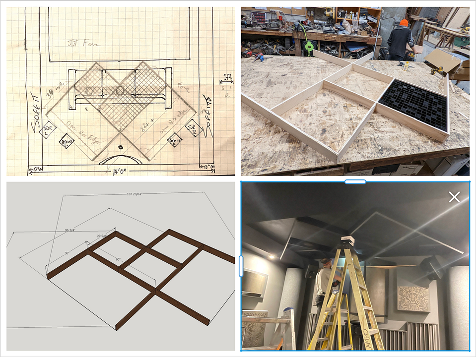

This project was completed in mid 2022 but seemed relevant to this thread... After adding Atmos overhead channels to our dual duty stereo & multi-channel big rig 2 years ago, I eventually decided to address the primary ceiling reflections of both the bed surrounds and the new rear Atmos channels. While at it I added some overhead 2D QRD diffusion as well.

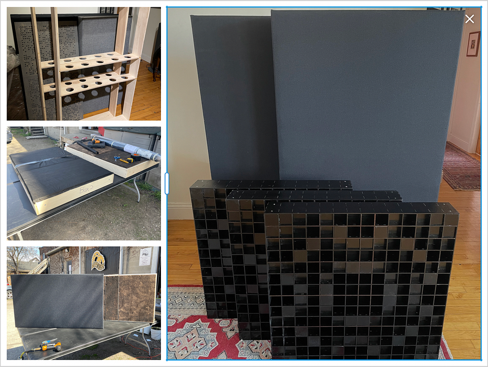

I’m a big fan of using the ceiling for acoustic treatments. In one setup I’ve got diffusion above my head, absorption in key places, and both broadband and bass-focused RPG devices at key points around the perimeter where modeling suggested they’d be particularly efficacious. In another setup we simply installed a “decorative” treatment in the beamed ceiling that is 3” fiberglass floated 2” off the ceiling surface. Both were transformative and leveraged otherwise ”unused” space.
