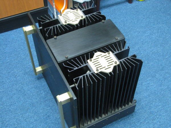

PS: To me this is NO regular 45 watts per channel amplifier.
Classé Audio DR3-VHC the vhc stands for Very High Current this amp is only 45 watts per channel class A the weight is 102 pounds.
Classe DR3-VHC 01.jpg Classe DR3-VHC 02.jpg Classe DR3-VHC 03.jpg Classe DR3-VHC 04.jpg Classe DR3-VHC 05.jpg
If you put a couple of bricks on it, it will be even heavier. :D
Seriously, wattage is wattage. Watts=V^2/R. "Current" plays no role there.
Where current comes into play is when "R" keeps getting smaller and smaller. Higher current amps will not current limit in the face of small impedance of speaker. At higher impedance they put out no more power however than any other amp with the same wattage.
View attachment 18342 View attachment 18343 View attachment 18344 View attachment 18345 View attachment 18346
The class A power specification is mainly established by the amplifier bias current . It is specified as the maximum power delivered by the amplifier to a 8 ohm resistor without switching off any of the active elements. The theoretical class A efficiency rating is calculated for an amplifier having a power supply with the minimum power supply voltage needed to deliver that power, ignoring any losses. Most of the time the amplifiers have much higher voltage in the power supply than this value, and can be operated at higher output power outside class A. I do not know the details of the Classé Audio DR3-VHC power supply, but it uses power capacitors with a 50V DC, 65V surge rating - I would expect such an amplifier to be able to deliver at less 200W before voltage clipping. But only measuring the power supply or looking at Classe data we can know exactly.
