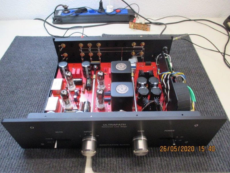

Preamp from Germany, MM or MC, Linestage transformer coupled, 4 * 6H30Pi.
Mundorf Supreme, Mills non inductive wirewound, pcb enig gold, ceramic sockets, Lundahl, Hashimoto,
