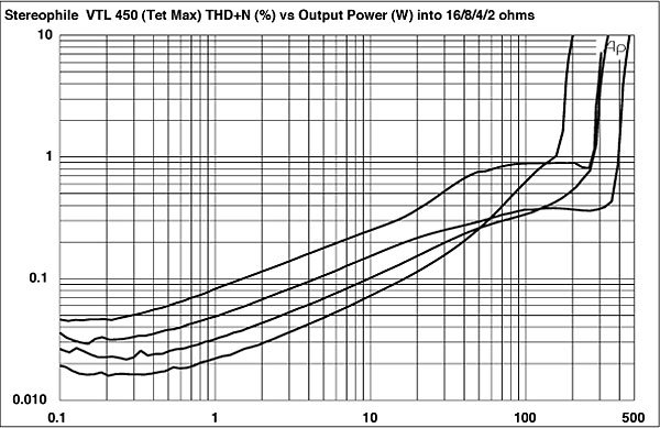

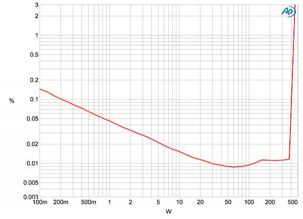

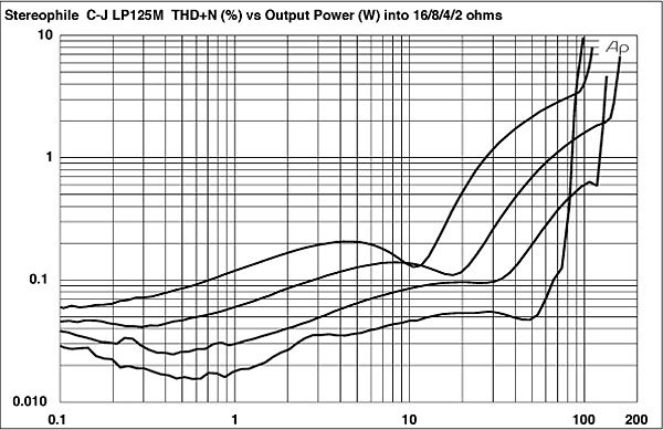

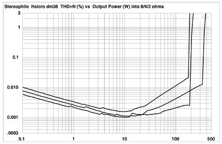

Distortion spectra, which starts out low , in the miliwatt range and then go high as power increases seems to fair better than those which starts out high then lowers as power is increased, when in subjective listening test ..this is believed to happen because sounds in Mother Nature ,reflected, or transferred, by any medium, are more distorted the louder they get , as such this distortions are then heard as cues to the media, not as distortions, Like when you hear a hammer striking wood, or a jet engine roaring , They are not heard as distortions, for this reason it is believed by some, That distortions by electronic media, which follow this similar pattern are not recognized as distortions, but is perceived as being more natural sounding.
Pictured below are test graphs showing thd vs power output , you will notice a trend as to those amplifiers people find natural sounding (tubes) and those they don't, you will also notice there will be both SS and tubes with out this type of spectra that still sound good to us and do not follow the measured vs perceived mantra, so there are other things going ( there are) on and as we progress a picture will emerge, starting with that first microwatt , forward thru PSU design, bias class, noise floor, load demand and last not least topology .
Hopefully and the idea , is that we will all get a better understanding via measurements as to what is relevant to us in recognizing what it is we find pleasant sounding and why in a specific amplifier's sonic signature .

A.wayne, Thanks for sharing the plots.. Boy it would be interesting to get these and about 100 more products to do a real analysis and break that down into groups.
