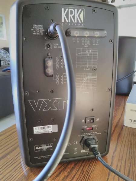

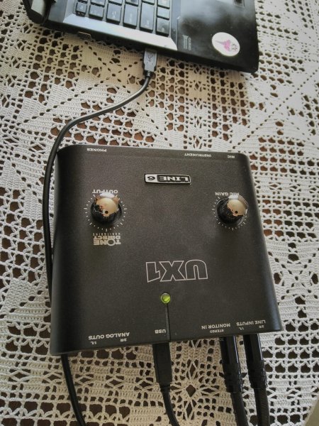

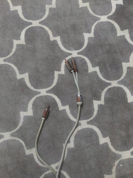

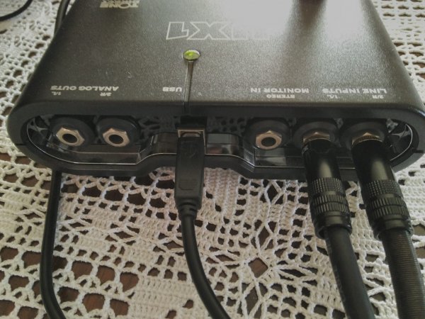

Hi again,
So, I bought the UX1, downloaded the drivers and selected it as the audio output device on my laptop. Cables should be working fine too but no sound comes out of the monitors... Troubleshooting didn't solve the issue. What could I be missing or doing wrong? Again, this is all pretty new to me. Appreciate your feedback! Pics attached.
Looks to me like you should have the cables going to the speakers in the "Analog Out".... NOT the input....
