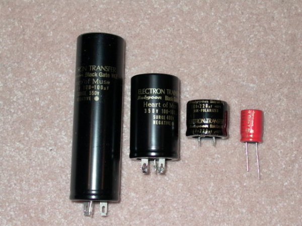

I thought that I would upload some photos of some things that I have now received for the Ampex project. The first photo is of the 6 expensive N series Black Gate caps (no longer available, out of production, and very difficult to find, and as a result 4 X what they used to cost) in the orange and the 4 Sanyo Aluminum Caps in Blue (they may also be out of production, but I am not sure). The orange Black Gates are some of the best and best sounding caps to have ever been available. The 10 caps in the photo plus 16 additional less expensive Black Gates (Roger has these already) and 54 Resistors that are on their way to Roger will be installed on the playback and record cards for the Ampex project machine.

Those "N" series blackgates are like gold. The sanyo's are out of production also. We will be replacing all the tantalum caps on the boards as their sonic qualities leave a lot to be desired. The original carbon composite resistors are out of spec as they drift with age, they will be replaced with top quality metal film types and some of those are out of production also. All these parts are low ESR and the "N" blackgates are ultra low noise.
