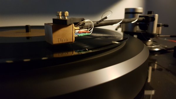

finally some shitty weather so I could reroute my DaVa fc supply wire on the Groovemaster and reconfigure the gnd scheme to The Head and then on to LCR riaa
now totally humfree

Hi Leif. What cable did you use for the DaVa dc power cable duty? Was it shielded or not and what AWG?

All of Leif's cables were unshielded silver with cotton

If ever there was a place for shielding it would be this specific application.

the DaVa Fc-1A dc cable is 2 isolated silver wires
Hi Leif,
By isolated do you mean physically separated only? I can see them on top of the arm. Before you had them going around the arm like a spiral in the photo.
I have been looking for small AWG shielded or screened cables for when I get the DaVa due to that proximity with signal cables.
Reactions: Hifi man
coated and physically separated
yes I´d like som too....
first I had severe "motorboating"
then I revolved around armtube and reduced it
then yesterday I rerouted twisted and on top of tube and rearanged gnd.....
result no hum, but still slight motorboating on full throttle
guess a shielded one would solve that too
would need to take 13vdc 100mA or so
