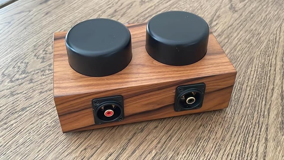

On FB was announced 1:50 SUT, 99,999 siver pimary/OFC secondary, Ideally suited for DaVa Reference, DaVa Soul, Ortofon SPU and others low-impedance (below 8Ohm) and low output cartridges.

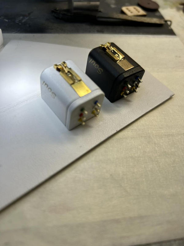

GOT my Soul from Darius 2 days ago.
We listened and compared extensively between NOS Kiseki Blue Longbody/Aidas boron and microridge in Ikeda 407, Supex SD 900/ Aidas boron and microridge in Dynavector DV-505 and DaVa Reference in Eugene Komissarow Harmony for two days. The Soul stays
Sounds like a fascinating comparison. For those like myself who have various DaVas (I have the regular and the mono version and the tube psu), could you offer some more specifics in the comparos, given how unlike the Soul is to previous DaVas....? Thanks.
I still have Reference and mono and just traded in A1
the Soul is in another league when it comes to resolution and extension in both ends compared to the Reference
the tonality is still the same
the A1 is in comparison a little more like chocolaty WE300B
both the the Reference and the Soul was installed in the outstanding Eugene Komissarow Harmony arm, and as such was given the same circumstances, when it came to tt, arm, cable, sut and riaa
theese are the ones I use
alternatively I have another cu both prim and sec
Reactions: bonzo75
No sure 1:50 SUT is a good choice for SPU.
My Thomas Mayer partial silver phono has 1:16 SUT and it seems to be fine with SPU with the volume being at about 9 o'clock.
I've tried 1:40 SUT with SPU and in my system there was too much gain.
