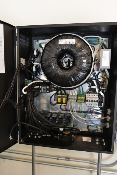

$11,000 + install, it's the 90A version with AVR and TVSS options. But for me it was worth every penny. Electrical problems around me had rendered my system unlistenable. I tried every Shunyata, Audience and a couple of other conditioners I can't remember, but they would only mask the problem. Now, every time I turn on my system, I have beautiful music instead of paralysis by analysis. Best money I've ever spent related to audio.
I got a sample when I borrowed a small Torus rack mount unit from my dealer. I heard true potential when I plugged everything, including my amps, into it. Cleaned up some of the problem I was experiencing. After that, I was fairly confident the panel would at least get me to where I could listen without hurting my ears. But of course I got a lot more than that.
