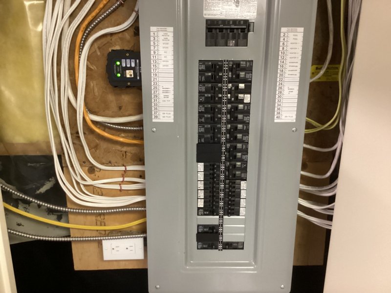

Here is a picture of the new panel. The three breakers at the very bottom are the audio lines. You can see the two armoured cables and the yellow Romex exiting the panel on left.

Mendel,
The installation looks very well done.
One thing is that if the 2 breakers on the left side are both for audio they are on different phases of the panel.
The breakers opposite each other, like the bottom 2 are on the same phase.
You might want to raise the second breaker on the left one more position. That would put it on the same phase as the bottom 2 circuits.
