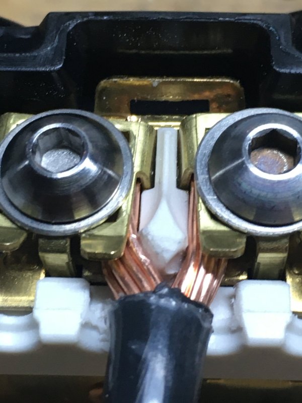

This is how I like to land a double duplex in a wall. Of course its deoxed, Teflon taped, then vinyl tape when complete. This is not easy to do. You have to get everything to length and placed where you want it before clamping the Ilsco C crimp. If you man handle it.(I mean, They handle it!!!), you will spin the tag wire in the crimp.and loosen the connection.
Use your imagination and this is how to land 2 x #10 branch wires under a single AFCI in a panel. You could even stack more tag ends if you wanted. This gets rid of eddy current from overlapping emf fields when.2.wires are under a wire nut facing the opposite direction of each other. It's just anal stuff I experiment and listen too. Its NEC compliment too.
