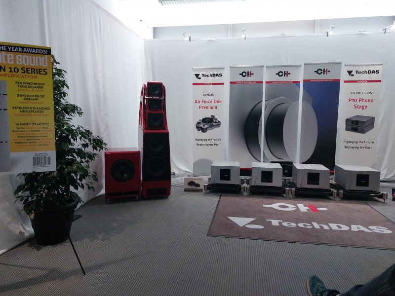

The Wilson / CH room as compared to the CH / Rockport Lyra room last year at munich was a prime example.
Wilson Alexx just lacks bass , they did place the speakers more to the side / back wall as far as i could see but still .
Same set up guys R gregory / stirling trayle afaik , same source same amplification same room

Wilson Alexx just lacks bass , they did placed the speakers to the back wall more in the corner as far as i could see but still .
Same set up guys R gregory / stirling trayle afaik.
You could only get as good a sound as the hardware lets you

Lol, the Alexx V has superb bass. If the bass wasn't there, then the setup definitely was off. Let's be honest here, the room acoustics in Munich are difficult at best.
Excuses excuses even with subs there was hardly audible bass.
Pics from the set up
I am not making excuses. I just have heard the Alexx V produce wonderful bass in people's homes and the recent Axpona. It's a terrific speaker. If there was little bass with the CH Precision setup then I am not sure what happened as Kevin Wolff knows what he is doing.
