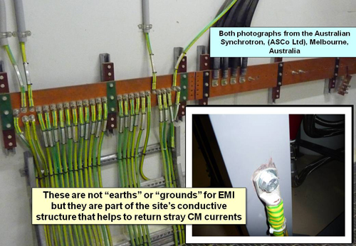

It's about running heavy conductors in parallel with the interconnects from chassis to chassis.
And he is talking about heavy conductors, maybe equal to three 10AWG wires. Although flat braids are better.
Now for a simple system or a long run to the power amps it's fine, but a big system with lots of interconnects it will be a mess.
Better would be a large copper bus bar/terminal strip centrally located, with a heavy conductor to each chassis.

Yep it is. Common Impedance Coupling noise is when two chassis are at different leakage current potentials and use the interconnect shields to equalize. So short Safety Ground wires or chassis-to-chassis PEC wires wire reduce the leakage potentials.
