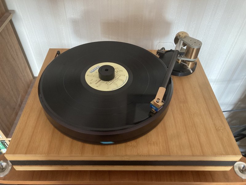

Based on my enjoyment of the Royal N I opted, somewhat on the spur of the moment, for a Gyger S rather than the original Ogura PA when my Transfig Proteus was retipped by Ana Mighty Sound. The Gyger claims 120 x 6 to the Replicant’s 100 x 5 and I can certainly find some similar characteristics and some differences from the comparison in two very different cartridge bodies.
I learn’t a lot about the peculiarities of setting up my Schröder while I was using the Royal N so comparison back to the PA equipped Proteus is more difficult. The quietness in the groove and relative insensitivity to pops and clicks seems much better with the Gyger S and Replicant 100 compared to the Proteus with PA or indeed the microline on a Dyna17D3. There’s not quite as much tonal richness from the Gyger Proteus compared to the Royal N but there’s more than I remember from this cartridge with the PA (but that may be where the improved setup knowledge counts). The Proteus has much more leading edge information where the Royal N rounded it off some what in comparison. Where the Royal N swings the retipped Proteus is up for a party but both can groove but in their own way.
The Royal N requires the brass mounting plate to handle its low compliance, tracks at around 3g and generates rather too much static in my discs, cantilever is a parallel aluminium tube.. For the Proteus I ordered a foamed aluminium alloy plate, tracking at the 1.8g recommended by AMS I’ve yet to notice any static since the rebuild, there was some when it carried the PA tip but not as much as the Royal N generates. Cantilever is still boron but AMS updated the suspension.
