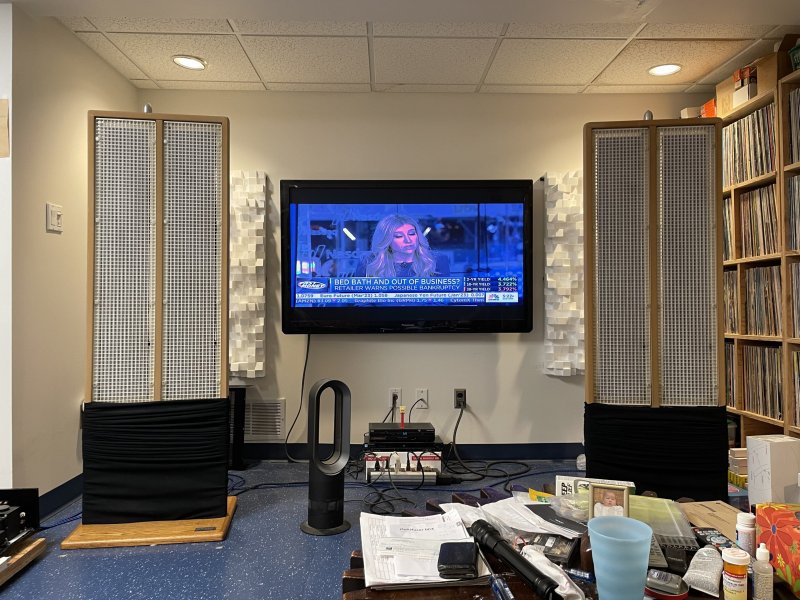

I am using Atma-sphere Class D mono amps with Quad ESL 63 USA panels with great results.
For improved bass and less work for the ESLs I use three 12" subs on DSP, xover 80 Hz single stage, and ESLs are on passive 80 Hz single stage high pass filter. No DSP for the ESLs. DSP setup software is REW and MSO. DSP hardware is MiniDSP 2x4 HD or Flex (adds a volume control useful for thin sounding vinyl).

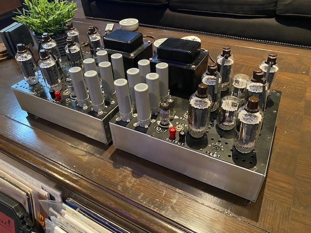

Not an OTL-3 but it's predecessor the Futterman.
Here are my pair of mint H-3aa's -mirror imaged and I have enough 6Lf6s to keep me going for some time I hope. I was still too young to afford OTL-3s when they were new -the Futterman always sounded as good or better to me. The notion of fireworks and run aways is pure hysteria in my opinion. Great on the ESLs.
