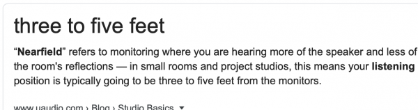

That used to be my thought as well mike
A quick google search gives this
Screen Shot 2020-07-09 at 3.37.22 PM.pngScreen Shot 2020-07-09 at 3.37.22 PM.png
Steve,
i guess we have the George Cardas audiophile listening room definition.....
verses......
the pro audio monitoring/mixing/mastering world definition.
i know which world i'm in. not sure the pro viewpoint is relevant for us. a whole separate set of uses and needs.

It is my understanding that the Cardas method is meant for small rooms dealing with reflection issues
every audiophile listening room is a small room with reflections issues. it's the actual definition of what domestic hifi speakers are designed for.
and your screen captures are for even smaller mixing rooms.
