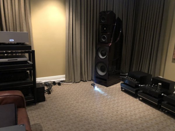

4. When Nick Doshi set up his tape preamp at my house he suggested that I move my speakers in by 1" and open the toe in by all of 1/4" change. Using a laser light that 1/4 change made a difference of 8" at each ear. This tended to soft the focus and since that day I have not moved my speakers

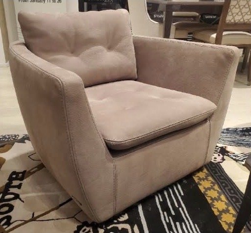

My first concern was how overbearing the large chair would be by moving it forward. I solved that problem by purchasing a new chair at Roche-Bobois in New York which is well built and has a firm back and a seat where my back is all the way back and my feet resting comfortably on the floor. Made of beautiful leather and I was hoping to have it by the time of this post but I'm told it arrives this Tuesday
I do have a picture of it on the show room floor but the picture doesn't' do it justice. I have to again thank my friend ddk helping me find this chair. The back is well below ear level and there is no concern that the seat with time will sag

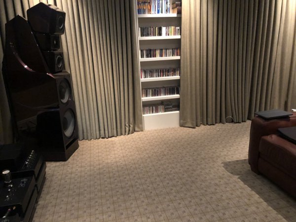

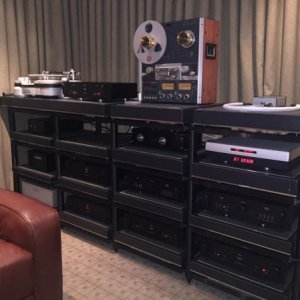

I have some photos to show that the chair has been moved forward almost 3 feet putting me only 4" behind where david pointed to all with very little work or effort

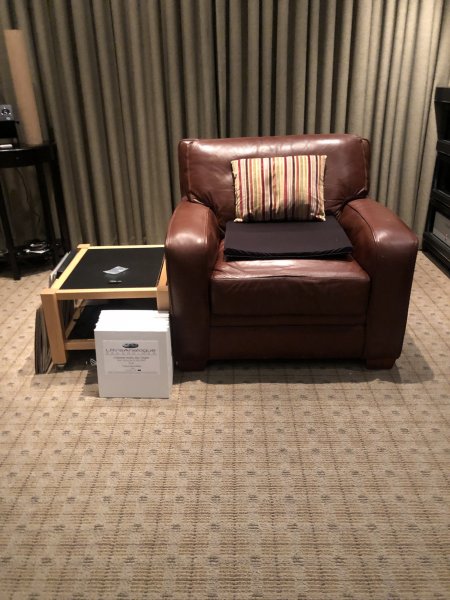

The above 3 pictures show how far back the chair was

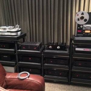

Here are some photos of the present seating position
Reactions: ack
If you look at the carpet each bold horizontal line is 4" apart. The chair was moved forward 8 of those bold brown lines

Previous listening position

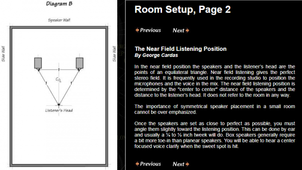

And last thing...,.. my calculated ratio is below Wilson recommendations at 0.947. Thanks to asiufy for having proved to me that it’s ok to be below that desired ratio. Let your ears dictate the end result.
Steve,
1--heartbroken i don't get a prize. but i will get over it.
2--near-field is not within 2 meters (not sure where that concept came from), near-field is simply at or inside the equilateral triangle defined by the tweeters and the listening position. in my room my tweeters are 115" apart, my ears 107" from each tweeter.....i'm 8 inches inside near-field. if you look at my room pictures it appears my chair sits almost up to the speakers, but the size/height of my speaker towers and the large room make it optically deceptive. your tall massive speakers have a similar effect. if you had small two ways it would not look so extreme.
http://www.cardas.com/room_setup_near_field.php

Peter, the laser was shined off the inside wall of each speaker. We put blue tape on the back top of my chair on both sides of my ears and marked where the light was before and after a 1/4" toe out. It was 8" further away from my ear
