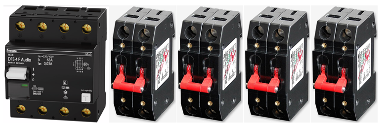

I am going to install 4 dedicated lines for my 4 devices (server, dac, etc).
One device per power line.
I am thinking of buying a GigaWatt G-16A 2P circuit breaker for each line.
The idea is that each element is independent.
So a total of 4 GigaWatt G-16A 2P circuit breakers.
Are Doepke circuit breakers a better choice in terms if sound quality?
In theory they shouldn't as they are differential circuit breakers.
I see that some of you are mixing the two types of breakers, is there any point in doing that?
I am not an electrician. I understand the differences between 1 pole, 2 pole and differential breakers.
But I don't know anything about the topology of domestic electrical installations.
In Switzerland it would seem necessary to have differential circuit breakers.
So I have two options.
One Doepke differential upstream and 4 GigaWatt non-differential downstream.
Or directly 4 Doepke differential circuit breakers
No idea which option is best…

The Doepke RCCB Switch and the Gigawatt circuit breakers have entirely different functions within an electrical circuit. The Doepke differential switch measures the difference between live and neutral lines and disconnects power when it senses a differential greater than 0.03A, caused when phase finds a route to ground….which could be via a consumer, who is then protected by the switch. The Gigawatt circuit breaker on the other hand is there to protect against an over-current draw above 16amps, which could cause a fire for example. A typical consumer unit would see a single Doepke RCCB feeding phase into several Gigawatt MCBs.. you‘ll find typical consumer unit layout diagrams somewhere here in one of the dedicated circuit threads.

The first option is correct (it is my case, only with two current lines), but in the second one I would have to add a Gigawat after each Doepke. Of course it would be an extreme case of separation of current lines, which I have never seen.
Actually, neither of the illustrated options are correct….In the first there are 8 circuit breakers….so you’d only need 2 of those dual rail Gigawatts MCBs to install a total of 4 lines
The 2nd photo is just the mis-application of the Doepke switch, which provides no protection against over-current and wouldn’t meet code anywhere. Essentially what’s needed is a single Doepke (to protect against accidental shocks) and either 2 dual rail or 4 single rail Gigawatt MCBs (to protect against over-current and potential fire)
Obviously the whole installation needs to be based on the same phase, but its questionable whether one line per component is the optimum choice. Its often better for hi-fi components to operate off a common supply and ground, which prevents stray currents circulating on ground planes between components, which can happen when they are independently supplied. Its why star grounding works…..all components have exactly the same ground potentials. In my system I have my network LPSs on one supply and my hi-fi on another….cable screens are all star wired to a low impedance ground, to avoid any continuity between components.

It seems to me that the Gigawat 2P cut both phase and neutral, in any case of a Gigawat 2P two rails do not split, therefore four lines, four Gigawat

Afraid I don‘t understand your comment. I’ve never used a 2 pole MCB but I believe you would use one for a high power device where you need 240V (120V system) or 400V (230V system) where 2 phases are sent to the device with a shared neutral return. In the event 1 phase shorts, both phases are disconnected. As we are not talking about hi-power devices, there’s no reason to use 2P devices.
BTW, I noticed I used the term ’rail’ when I should have said ‘pole’. Too many power supply posts
Anyway, here’s what’s needed

Regardless of the reason for using a 2P Gigawat instead of a 1P, the truth is that the photo above is correct: 1 Doepke and 4 Gigawat for 4 lines.

There are technical reasons for selecting one over the other. SwissTom, any particular reason for needing a 2 pole MCB?
4 Gigawatt 2 pole MCBs (as shown in the photo) have the capacity to control and switch 8 inputs and outputs, so that‘s either 4 dual phase inputs to feed 240V (120V system) or 400V (230V system) equipment via 4 core cables, or 8 single phase inputs via 3 core cables.
For 4 single phase lines, which is what I believe we’re talking about here , you need either 4 single pole MCBs or 2 dual pole MCBs. Given that dual pole cost twice as much, occupies twice the space in the CU and switches 2 lines simultaneously they would be the wrong choice for 4 independent lines of the same phase. Why? Because if one of the two attached components became faulty and the resulting overcurrent caused the MCB to disconnect, you wouldn’t know which component was faulty because the dual pole MCB switched off both.
