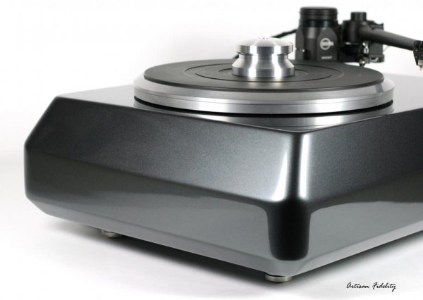

Christopher T. . .I posted some pics of the SP10 you're building for me on page 42 of this thread. Can you share any information about the build? Any additional photos?

Artisan Fidelity Technics Sp10Mk2 Next Generation
Bob, Certainly. Your next generation Sp10Mk2 model features a directly coupled main bearing/motor housing with integral shielded bearing drain, void-less high mass AF Panzerholz plinth, constrained layer damped multi substrate core with integrated active isolation technology by Stillpoints. The phase/speed/logic/control pcb's housed in an external shielded and damped chassis with internal common ground hitch mount, control umbilical fully shielded from controller to motor assembly. Your SH-10e power supply has all the goodies - premium Panasonic and Nichicon capacitors throughout and bench tested/scoped. Of course, phase tracking timing bench test, frequency and reference oscillator motor level calibration, master clock crystal and axillary main board inspection, power supply voltage and rails adjusted and scope checked and last, but not least the removal of the brake mechanism rounds out the job nicely :b Will post pictures of the speed control/logic chassis once completed. By the way Bob, your next gen table is the quietest running Sp10Mk2 I've yet to hear, we are talking pitch black backgrounds here.
