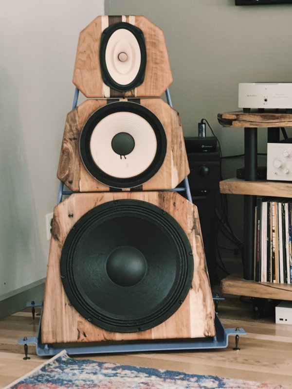

I am using the Classic Audio 4" compression midrange with Beryllium diaphragm, and their 15" woofer, and upgraded to Tungar field coil power supplies. I have noticed a huge difference from the JBL 4250 and Altec 505C I was using before. The biggest difference is in the subtle aspects of musicality. The distortion is noticeably lower, with more realistic micro and macro dynamics. For example, the decay of the sound of percussive and plucked instruments, the ambiance surrounding the instruments, and the sense of unlimited dynamic expansion during crescendos. After adding the plasma tweeters, transparency went up another notch. There is no sense of strain or harshness during complex, loud passages. I am very happy with the decision and has no urge to change anything now.

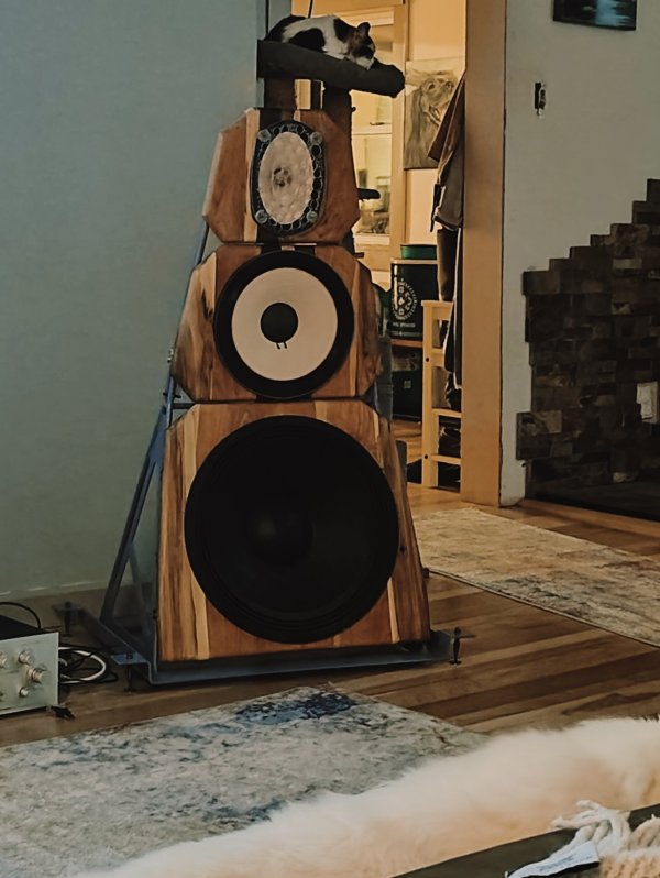

I'm waiting on a pair of T1.5 Classic Audio speakers. They sounded great at the Capital AudioFest. They use the field coil technology. High sensitivity. Expansive 3D sound field.

Congratulations on your upcoming T1.5’s. If i might ask, which wood finish did you choose?
After years of listening to TAD 8Ω T3’s at a dear friend’s home, a couple of years back, I took the jump with John Wolf and acquired 16Ω field-coil T3.3’s in rosewood. Given that John lives about forty minutes away from me, it was great for having them delivered. I’m currently running dual solidstate power supplies to each loudspeaker, driving the horns and super tweeters at 15VDC and the woofers at 18VDC per John. They are performing wonderfully. Tungar may yet be another step for me. So far, I’m absolutely delighted with their performance.
