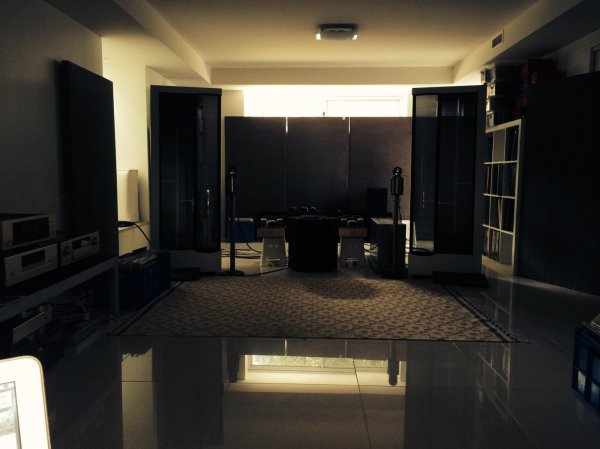

Room set up from listening position today
Sorry its dark autumn mornings in Canberra lol
My understanding from previous owner is the coating on tiles is sound deadening despite shiny finish
Certainly the room is nowhere near as alive as photo might suffest :)
You have a great system from the cd/sacd transport and dac all the way through to the speakers.
The room is the only fault I see and least expensive to correct.
It is every bit as live as it looks! DON'T RESIST!!! We want you to have a successful resolution to this.
The previous owner has no idea what he is talking about regarding sound deadening on the tiles.
To start, get more rugs.

Let me join Gary in reinforcing the importance of treating your room, and I say this from experience setting up and tuning a large ESL system over the past decade +.
Based on your descriptions, and judging from what I see in pics of your current room, you likely have serious HF ringing that will mask *any* change in upstream gear.
HF Ringing is the bane of many an ESL setup, but once tamed, you will love these speakers even more once you get to hear the music, and not just room resonances.
So please put down some rugs right away, dampen the rear wave even further with absorption behind the speakers, and if your seat is indeed more than 2m from the rear wall, add diffusion back there.

Ringing at a set frequency makes some sense from what I am experiencing
Back and front wall have absorbent panels as more than 2 meters
Think floor and ceiling are next to attack

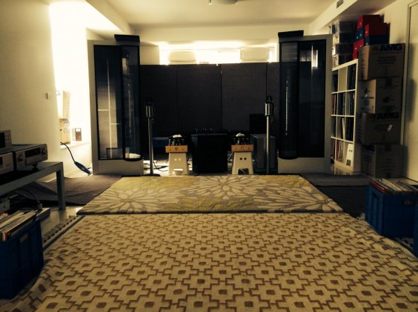

Layed down old carpet squares all over the floor today
Big change!!!!
Still a little "sizzle" at some pitches but maybe 10% of before
Huge improvement in articulation and inner detail
Getting that amazing effect where instruments start projecting in front of the speaker plane
So must be on the right track

Room with increased softening
