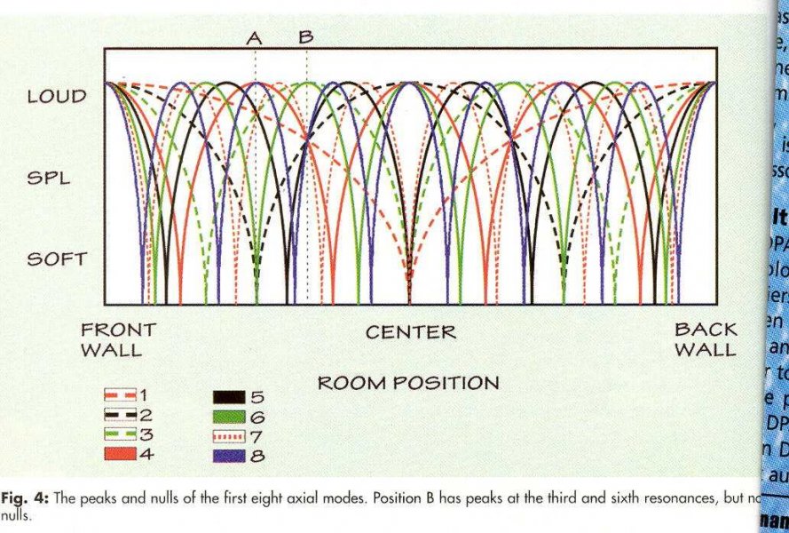

About Face: Using the Graham Stands with the Graham LS8/1 Speakers
Well, you should have at least tried that first, you're saying! Yes, you're correct. But I didn't. In my initial view, placing the speakers on stands which at 20 inches tall was necessary to sit comfortably in my regular Drexel overstuffed chair while putting my ears on axis with the lower tweeter, as clearly sounds best with these speakers, and which is the axis endorsed by Derek Hughes, the designer. The 4.25-inch taller Skylan SKY-20 stands I was using shouldn't work to the sonic detriment of the presentation, I thought.
I only got around to trying the OEM stands because a friend also bought these speakers and is thrilled with their sound on the Graham stands. At first he was tilting the stands back a bit, something I did not want to do for the reasons I've explained before. But now he purchased a new chair which is very low and gets his ears at the right vertical position, even with the lower tweeter, without tilting the stands back at all.
When mounted on the Graham stands (which are 15.75" or 400 mm tall without spikes or bumpers on top--just the metal part of the stand), when I include the little rubber bumpers (about 1/8" high) and a few felt pads beneath the base of the stands to level them, the center of the lower tweeter is about 34 inches above the carpet.
My own Drexel chair can get my ears that low if I take the seat cushion out. The seat cushion can be used as the back cushion if I want to sit most erect, or I can continue to use the back cushion for a bit more recline and less cushion near my ears (a good thing). I've used this Drexel chair many times before without sitting on the seat cushion with low floor-standing speakers, such as all the Gradient models. The chair isn't as comfortable that way since the seat is a little harder without the seat cushion and it's harder to get out of the chair, but that's a low chair for you.
Anyway, I bit the bullet and set up the speakers on the Graham stands. The supplied spikes are too short to both pierce my carpet and level the speakers on the floor. It's an old house and the floor is not exactly level. I'm using the supplied 1/8-inch-high rubber bumpers Graham supplied as the interface between the speaker bottom corners and the stands. I'm using one or more thicknesses of furniture padding felt (1-inch squares) under the corners of the stands to level the top of the speakers front to back and side to side.
Not the most rock-solid mounting, but I've most always preferred to "float" speakers atop carpet rather than spiking the stands to the floor. "Floating" minimizes nasty high frequency resonances from ringing metal stands and bass resonances from the floor. The bit of sway that can be induced in the speakers if nudged is of a very low "you can count the cycles" frequency. This "spring" mounting thus filters out all vibrations through the stand at frequencies in the audio range, 20 Hz and above, which is well above the sway-frequency resonance of just a very few cycles a second. (For a thorough treatment of spring theory as applied to audio equipment isolation and resonances, see the wonderful old treatise by Shannon Dickson in Stereophile, "Bad Vibes.")
So how does the sound of the Graham LS8/1 speakers on the OEM Graham stands compare to what I was getting with the speakers on my 20-inch-tall Skylan stands? As wonderful as the Graham speakers sounded on the Skylans, I now have to admit that Graham has it right: the speakers sound even more wonderful on the lower Graham stands!
There seems to be "more meat on the bone" with the lower stands. The overall balance is tilted a meaningful bit toward the lower ranges, perhaps because of less harmful floor bounce cancellation in the power range (100 to 300 Hz, say), which is helpful in my set up to my ears. This was clearly audible even before dialing in the speaker positioning in the ways I described earlier in this thread; see especially posts #11 and #12. Everything else about the tonal balance seemed about the same, which is good, and the focus and staging were already excellent, even before dialing things in.
After dialing in the speaker positioning, the imaging and staging achieved new levels of spectacularity. Thus, the Graham stands improved not only the perceived frequency balance, but also all the spatial aspects of the music! In addition, the sense of clarity and seeming lack of distortion further improved.
Keep in mind that only the speaker stands and seat cushion changed in this comparison. Everything else about the equipment and set-up stayed the same.
How much of the sonic change resulted from "correcting" the height of the woofer/port with respect to the floor, how much resulted from eliminating the top plate of the speaker stands so that the bottoms of the speakers are freer to vibrate, and how much resulted from the 4.25-inch change in my listening height with respect to the floor and ceiling, I do not know. I do note that a listening height of 34 inches is close to 1/3 the distance between the floor and ceiling of my listening room (the room is 103.5 inches high). The 1/3 position may more equally represent to my ears the floor-to-ceiling room modes in the lower frequencies. See the 1/3 position (labeled "B") in the attached chart of the first eight axial room modes.
In any event, my new recommendation, if your sitting comfort can accommodate it, is to sit with your ears at 34" above the floor when using these speakers and to use the LS8/1s on the Graham 400 mm/15.75-inch-high stands. If you don't mind "looking down" a bit on the soundstage--as if from the balcony at a concert hall--then you could try a more comfortable, higher chair and angle the speaker stands back a bit to aim the lower tweeters directly at your ears.
Note that while the Signature Edition of the Graham Audio LS8/1 speakers came with these Graham stands, the stands must be purchased separately from Graham if you buy the non-Signature Edition of the speakers.IMG_9783.jpgIMG_9782.jpg
