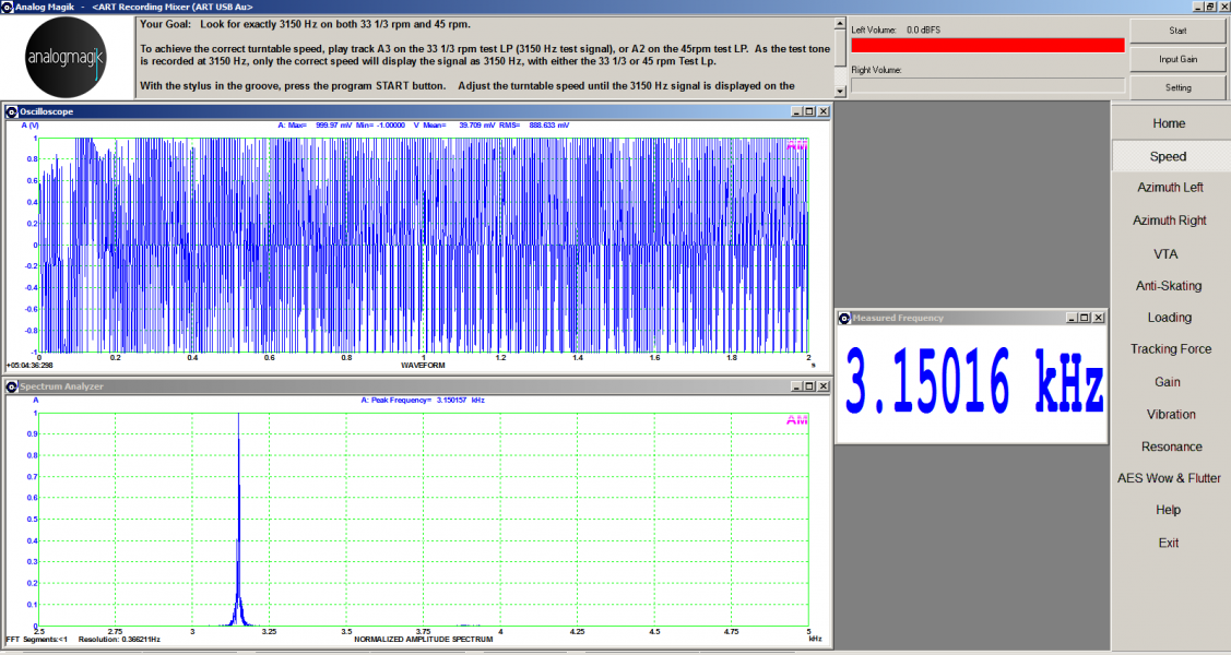

The peak deviation from a perfect 33 1/3rpm rotational speed for the Monaco 2.0 is typically better than 0.0001% (1ppm) -- that’s actual platter motion, not a quartz-locked specification. I expect the 3.0 to offer improvement over that.
Imo, it is difficult to grasp the sonic influence of stable accuracy from numbers. Typically some say "can I really hear the difference between n and n+1?' Wow and flutter is not the place to look for improvements. They proved unmeasureable on both the 1.5 and 2.0.
This is from my 2.0. I've seen better. But AM and phone gyroscopes are not going to give actual platter speed. I have no interest in debating on this and prefer Alvin explain the technology of rotational measurement.
Unfortunately no turntable was ever made with unmeasurable wow&flutter. Every mechanical rotor/platter on an analog playback machine has a wow&flutter figure. It can be very small or unnoticeable but still measurable. It’s inherent with mechanical motor-platter systems. Only digital playback systems with buffer or memory have unmeasurable wow&flutter. They can reproduce sound without any fluctuations in speed.
If you want to hear how your turntable’s wow&flutter sound like you can simply play AM test record’s 3150Hz track. You will hear speed deviation as shift in frequency. This shift in frequency is total wow&flutter of lathe and your turntable. Check by yourself and decide if it has an impact on sound or not.
You can use other test records but make sure their spindle holes are in dead center. AM test record is good in that regard.
I cannot say that the Monaco 2.0 has no wow & flutter. I agree it is an electro-mechanical physical device and not perfect. I can only relay what I've learned from the table itself and from talking with Alvin Lloyd.
On my table there is no audible frequency shift to hear. You can question my ears if you like. I'm telling you my experience.
From my conversations with him I believe Alvin's view is that the Monaco is more accurate and his measurement equipment is more accurate than a physical test record's signal fed to an algorithm through a stylus tracking a groove. His data comes from reading the platter directly using marks engraved on an encoder ring at the platter's circumference. The 2.0 table reports platter speed to the controller at the rate of 166,289 times per second (299,320 times per revolution), running at 33?rpm. The rate is actually greater than that according to Lloyd; he tends to be conservative in publishing specs and my nda won't let me say. I invite you to contact him for more information.
Published specs:
Speed Deviation
Peak deviation from mean (33? rpm) = 0.00008% 3 sigma
R.M.S. deviation from mean = 0.000057%
I don't want to debate about AM or other measuring systems; AM is a fine tool, it too is not perfect. Different measuring tools give different results. Every test record is different and different test records yield different results.
