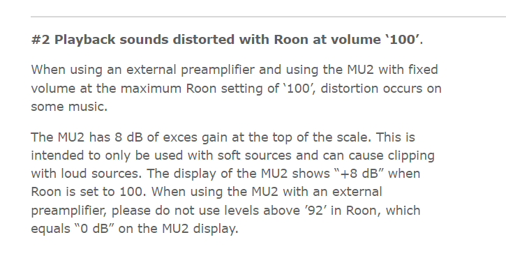

@gerihifi I'm curious about how you arrived at - 7bB for the MU2. I assume you just iterated through various settings until your ears said this was the best setting.
Hi, it's a general thumb-rule (my opinion) and not put it on max - always around 85% of max volume if preamp is attached. Also see Grimm FAQ:
- This rule doesn't apply in setting done mentioned earlier, as you set the MU2 to "Fixed Volume"
- As advised with "fix volume" in roon device setup, this doesn't apply as well:
BTW: Eelco Grimm mentioned to me that MU2 nativley supports DSD up to 256 (I completly overlooked that) and they also do their magic 1.5bit instead of 1bit data conversation. I tested some DSD256 albums and I'm pretty impressed - highly recommended to test!

Eelco Grimm posted this a day ago:
We regularly test the output of Roon in 'Device volume' mode to make certain that it outputs the data bit-transparent. We do not test Roon in Fixed Volume mode since in the past we have seen some issues in that mode and most people like to have the convenience of controlling the volume from within Roon so 'Device volume' is more important to us. I presume those issues are solved now, but if you use 'Device volume' you are certain that we looked after it. Note that with 'Device volume' you can still set the MU1 or MU2 to fixed volume in the GRUI web interface.
On another site there was a question about fixing the volume level. Eelco responded as follows (I highlighted the part that refers to the MU2's design):
"The procedure with the current MU2 firmware to achieve a 'fixed volume' is as follows:
1. Put Roon in 'Device volume' (always...).
2. Dial in the volume that you like the MU2 to play at. It can be any volume you like, just dial it in with the top control knob or Roon's volume setting.
3. Make certain that this preferred fixed volume level is at or below '0 dB' on the MU2 display.
4. Click 'fixed volume' in the GRUI web interface.
From now on the selected volume will always be used. The sound quality is the same for any selected volume level. The same electronics is always in the signal chain, the relay volume control system is part of the DAC buffer stage. With 'fixed volume' you just fix the MU2 volume control to a certain setting. So for the shortest and most transparent signal chain, leave out an external preamp. If you wish to 'color' the sound with an external preamp, that's perfectly fine of course. In that case you can fix the MU2 volume control as described above."
Currently trying the -7dB on the Grimm (Roon = 85). For this experiment, the Roon volume setting = Device Volume. Will try Roon Fixed Volume too.
