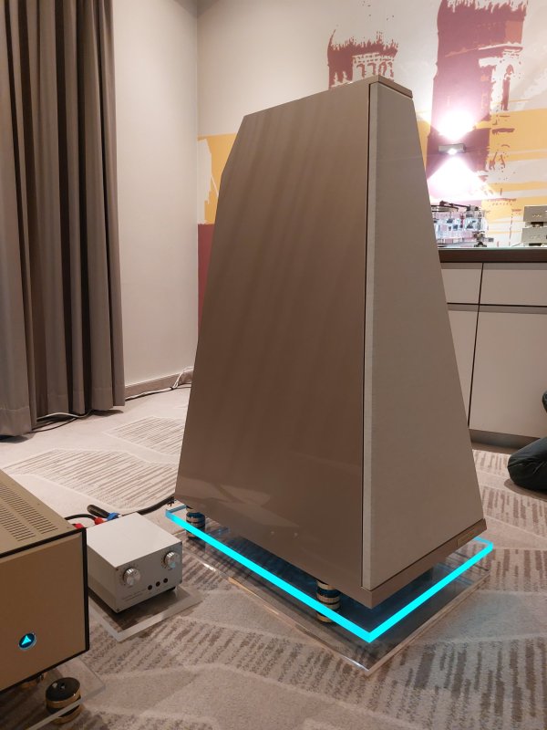

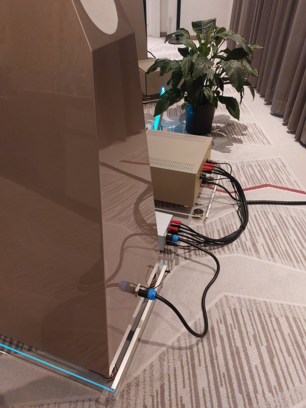

Below are not facts just what i picked up from M Huber YT vids
FM acoustics splits the signal in Bass and mid / high freq .
The amplified signal goes directly to the speakervoice coils.( the potmeters at the back on the speakers are for tw adjustments , i think ).
No coils / caps (X over) in the speakers themselves .
The already seperated? amplified signal comes in the small box ( bass / mid high level adjustments ?)and goes to the speakers drive units through the thick black cable it looks like.

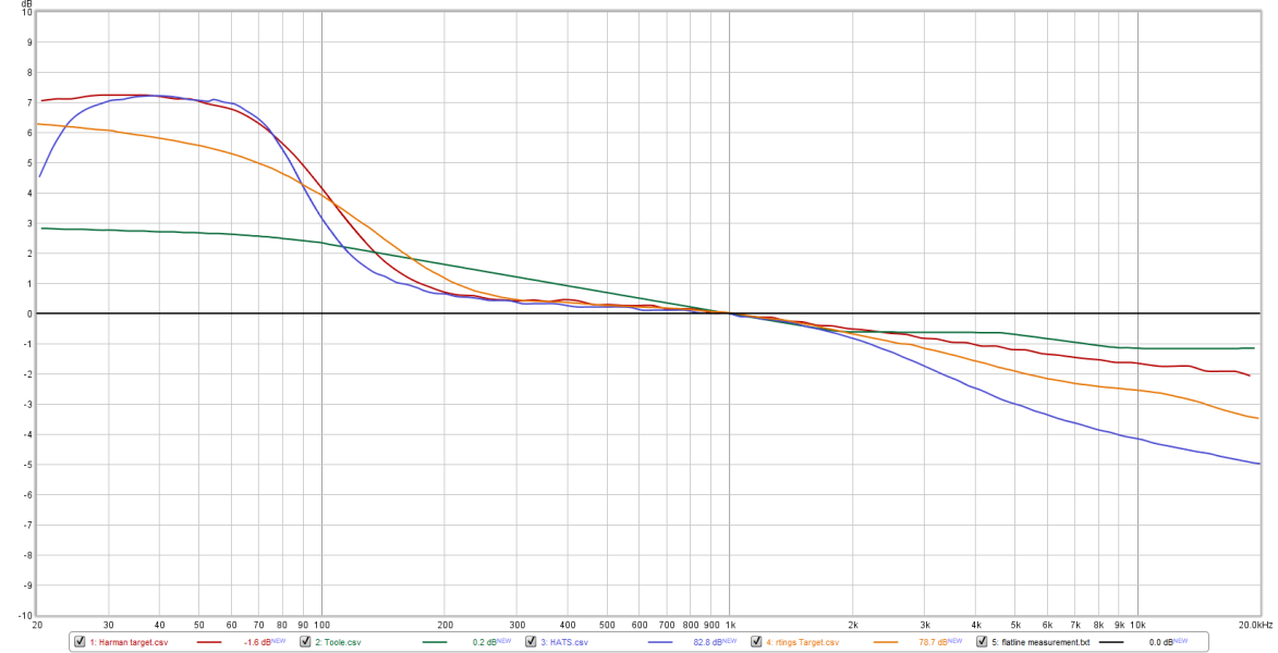

As far as level taking Fletcher Molson into account, depending on listening levels you may have to run the subs a bit raised in SPL to achieve what is perceived as equal loudness
Here is a group of target curves as an example
Rob :)
