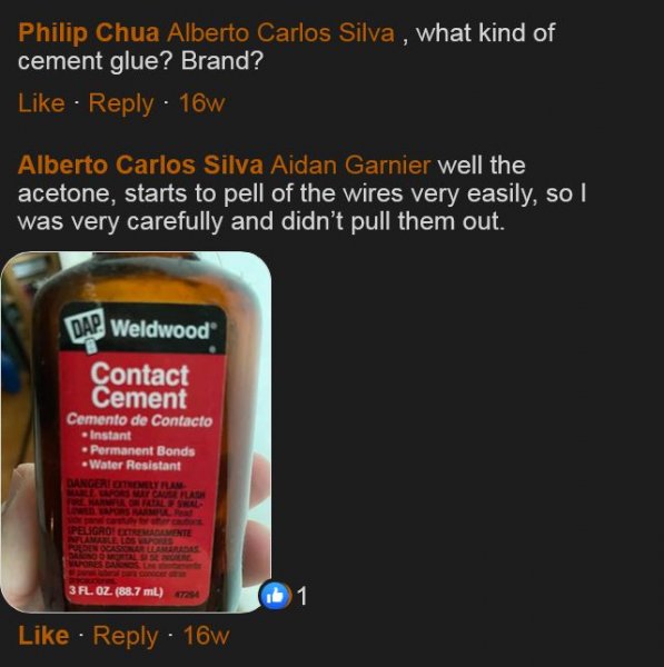

I have been chatting with members of the Magnepan Users group on FB for years and they have been very helpful. Here is what a member used as glue.
Alberto Carlos Silva Aidan Garnier I’ve done it over a weekend (could not stay two days without listen to them). Remove fabrics, clean Mylar with cotton and acetone. Glue delaminated áreas with cement glue, you can apply 3M77 afterwards (I didn’t). Apply metal pieces to force pressure against magnets. Done, 4 years till now without further buzz or rattling noises. But I’m only talking about delamination at the panel extremes, I don’t know what is your case.
