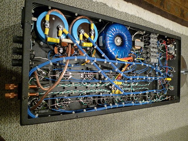

Which I wrote about in a review of Ralph's MA-1 mk.3.1 !
Edit: I keep listening to that song and use a gear's ability to resolve Willie as an assessment tool. I should add that that Atma-Sphere amp revealed Greene's voice more clearly and distinctly than any amp I've heard since.
