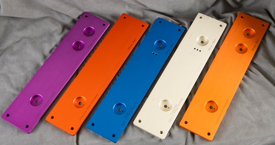

Hey Emile, may be you should give Thomas Mayer a buzz and see where he does his anodising ?
Seeing as he is in possibly the most bike friendly country on earth. I'd be willing to bet local anodizing company he already uses is top tier. That industry is almost singlehandedly responsible for the current widespread usage.
The problem you are going to have is getting an exact color result without having numerous highly similar samples shipped to you for final sign off.
I'm just teasing Emile, but having said that if colours were an option I would definitely choose something more dramatic than black or silver.
