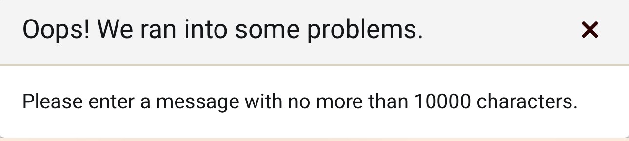

I’ll quote some of my posts for context.
