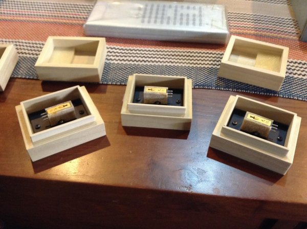

Finally, our Koetsu Coralstone Platinum carts arrived from Japan. Beautiful carts and first impression of the sound is simply heavenly. Coherence from top to bottom is superb.
Wow.... eye candy!! Would love to have one of those!!!
Congratulations, Tan. :) Lovely. Just looking at the 'boxes' makes my heart beat faster again. :D Heavenly, I can believe it. :)
Thanks, Phil, especially for your recommendations. The KCPs are real keepers.
