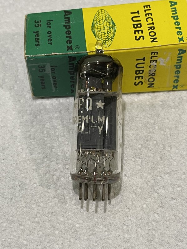

At the capital fest I noticed that a horizon was using a 12AT7 with an adapter in place of the 6sN7 tubes. Can you also do this with a Baltic 3?
Are you sure it wasn’t a 7119 / e182cc tube? They are taller novels, dimensionally similar to el84 and I'm told can make a good-sounding sub for 6sn7. Here's one from my stash, an early pinched waist D getter version.
