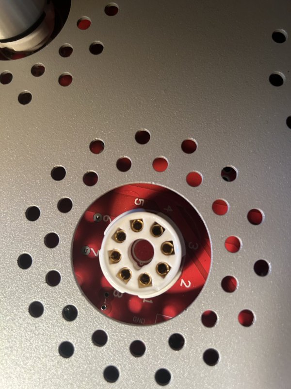

Another (new) member here just reached out to me having used a pair of EL34's with a GZ34 and burned his transformer. He has much more experience (40 years) with tubes, power/pre/rectifiers than I do and was very surprised by the meltdown. He hasn't publicly posted his experience and it's not up to me to use his moniker. He's waiting on evaluation of his A3 at Lampi central. Mine was repaired but no diagnosis offered beyond the initial surmise that the rectifier or adapter was bad - I still have them, but haven't found anywhere/anybody to test them. It does makes me curious if others out there have had the same issues and not part of this forum or site or just not posting. If someone here is interested in testing my tube and adapter, I'm happy to send it.

Also, see the concurrent discussion in the Horizon thread about a loose socket.
You may want to check with the factory, however, with over 40 years of tube rolling and building- what I can tell you is that current production Chinese sockets are horrible. They do not hold their tension are made of inferior "metal "and are, unfortunately, the only game in town for exotic 4 pin types (UX-4 etc) .Surplus NOS supplies of sockets are pretty thin and expensive and are not conducive for production.
I go out of my way to avoid Chinese sockets of any type.
"If" the Lampi sockets are Chinese -- they won't stand up to to tube rolling. You are asking for trouble by doing anything outside of ordinary tube replacement. Once almost any socket looses tension - it is toast. Once a Chinese socket loses tension it is garbage because the quality of the metal. Some old US production types could be re-tensioned - but even so, it is the beginning of the end.
Another warning , if sockets are directly soldered to the PC board with out any mechanical fastening to a bracket or chassis - you will compromise the soldered connections over time with excessive tube rolling by flexing the board with excessive insertion and removal.
Reactions: Agent86
Obviously if folks are jamming any tube which "kinda fits" into their Lampi tube DACs they will eventually get what they deserve - and it'll not be the mind-blowing performance they may have hoped for.
However, in both of these Atlantic reports it is my understanding that the tubes used are electrically compatible with the TRP. Remind me of the details of the earlier one (Budburma?) but I think there was an adapter in play also. But this recent report was with EL34 & 5AR4, which are tubes specifically identified in the user manual and back plate on the DAC as compatible. My wild guess is a faulty transformer, but details are unknown.
I've heard of folks cleaning their old production tube pins with fine brass brushes or steel wool and later having a melt down because a tiny metal fiber was left on a pin and caused a short. Not saying this is the case here, obviously, but a full account of the incident and lead-up may contain clues.

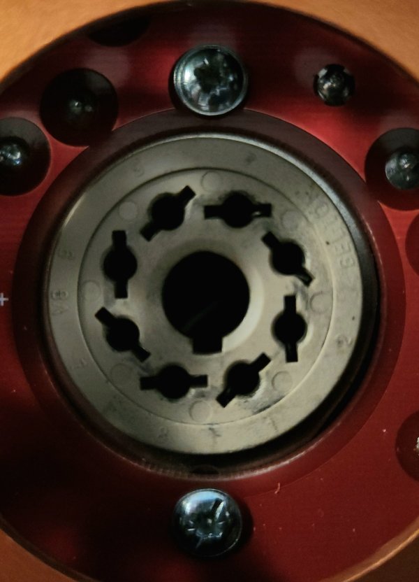

The TRP is MADE for tube swapping. You would think the sockets in use are up to somewhat frequent tube changes. The sockets in mine don't look like any of the cheap sockets I typically see coming from cheap streams out of China. They are quality Belton units made from incredibly durable glass fiber resin. The sockets themselves appear quite up to task. And the sockets are indeed secured to the circuit board, not relying on the circuit soldering to hold them in place.
It's true that NOS sockets are rare and wildly expensive if they can be sourced. And true that many new sockets are a bit dodgy for tube rolling, but not all as evidenced by the Beltons which are readily available. However high quality new production sockets are also available, including UX-4 etc from Yamamoto.

Yes, a previously used adapter with a previously unused (by me) rectifier.
The sockets in my A3 are ceramic with uncertain origin and mounted directly to the board - it's given me cause for pause actually (along with the transformer meltdown) and my rolling is slowed way down. I had to out stanchion supports in a phonostage for the same reason - too much flexing with tube changes. I haven't used a rectifier with an adapter since, but do continue to use two from a maker on Head-fi for my 7193's because they sound soooo gooooood! Actually have a TP pair on order, too.IMG_5347.jpeg
the tube sockets are pretty much stock standard.i find that most manufacturers just use chinese made sockets - the horizon one i think is from cmc - it is a teflon socket rather than ceramic. with silver coloured contacts not gold coloured ones. i have toyed with changing the sockets on my board to a yamamoto but the ones on the horizon are not plate contacts but solid lugs which means they are quite painful to remove that socket you have there bud will not be the cause of a transformer blow. Trannies blow when they draw too much current, is there a photo of the gz34 tube he used that i can have a look?

This is an A3 TRP? Looks SO different from mine...
