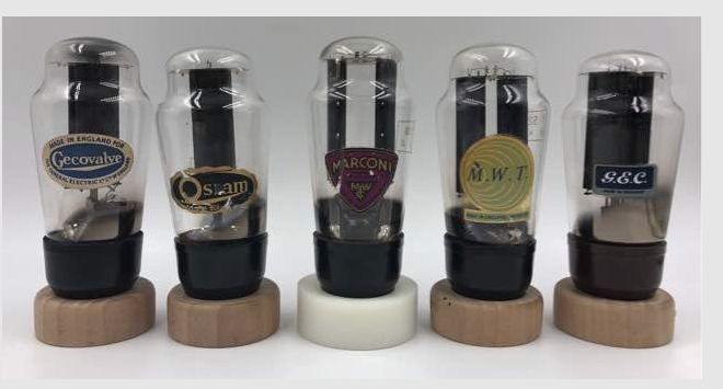

In DubStep Girl’s massive rectifier review, there is no shortage of accolades for this rectifier so its worth lifting it (with full acknowledgment) in its entirety from Post #1 of this monster thread.
https://www.head-fi.org/threads/dub...mparison-rectifer-tube-rolling-thread.694525/
“British tube made by GEC/MWT/Marconi/Osram, etc. I've also seen it branded under Mullard or Brimar. It should be compatible with most 5U4G amps. Mine has grey plates but I've also seen black plates as well as black base versions of this tube. Compared to the Western Electric 422A, I think this would be the second best rectifier tube available. Performance is almost the same as the Western Electric 422A, perhaps only being a little warmer and having a more euphonic tone/timbre/decay. However, it maintains its speed, transparency, layering, soundstage, and imaging. Like the WE422A, it's pretty much nearly perfect in every way and maintains a sort of neutrality throughout. Warm tube sound but with extended air and treble, great staging, deep bass extension, very nice texture and decay as well. Absolutely zero grain with this tube, just like the WE422A, one of the best tubes out there! Sound-wise, it's very similar and shares the same British tone and sound signature of the GEC 6AS7G power tubes. Just like the WE422A, this tube can really bring you to tears on the right music, so much magic in the sound of legendary tubes. Price is slightly cheaper than the 422A but similarly priced with tubes going for $350-500$ a piece.”
With the U52, the sound of any good Steinway recording has alas returned from a slightly darker sounding piano to the openness and clarity that is synonymous with the sound of Steinway D! In fact, this clarity is apparent not just in a piano but in everything from human voice right up through the violins to the air of the hall. Oh yeah, the U52 is about 1/3rd of the cost of the $1200 Tak, so that's a huge plus as well. Cost aside, the U52/ECC32 combo is utterly authentic sounding to the sound of instruments I hear in the hall or club which its why they're keepers for me.
Recall I mentioned I will likely never sell my Sylvania B65’s even though the Mullard ECC32 is my triode of choice. Well, I would make the same comment for the Takatsuki. I won’t part with it because it still amazes me with what it offers in the integrity of its low through upper bass. So it’s a reference worth inserting from time to time if for no other reason than just to check one’s sanity and system gestalt when playing with things such as cables, fuses and other assorted audio gear or accessories.
So that’s the update in a nutshell. In summary, I’ve gone all British with Mullard EL-34 pentodes, Mullard ECC32/31 triodes and a MOV/GEC U52 rectifier. It’s the combo that work’s very nicely together in my system. It’s hard to believe I can actually say I have no plans to change any more damn Horizon tubes in the foreseeable future, but that’s where I am at the moment.
With the U52, the sound of the Steinway has alas returned from a slightly darker sounding piano to the openness and clarity that is synonymous with the sound of Steinway D! In fact, this clarity is apparent not just in a piano but in everything from human voice right up through the violins to the air of the hall. Oh yeah, the U52 is about 1/3rd of the cost of the $1200 Tak, so that's a huge plus as well. Cost aside, the U52/ECC32 combo is utterly authentic sounding to the sound of instruments I hear in the hall or club which its why they're keepers for me.
