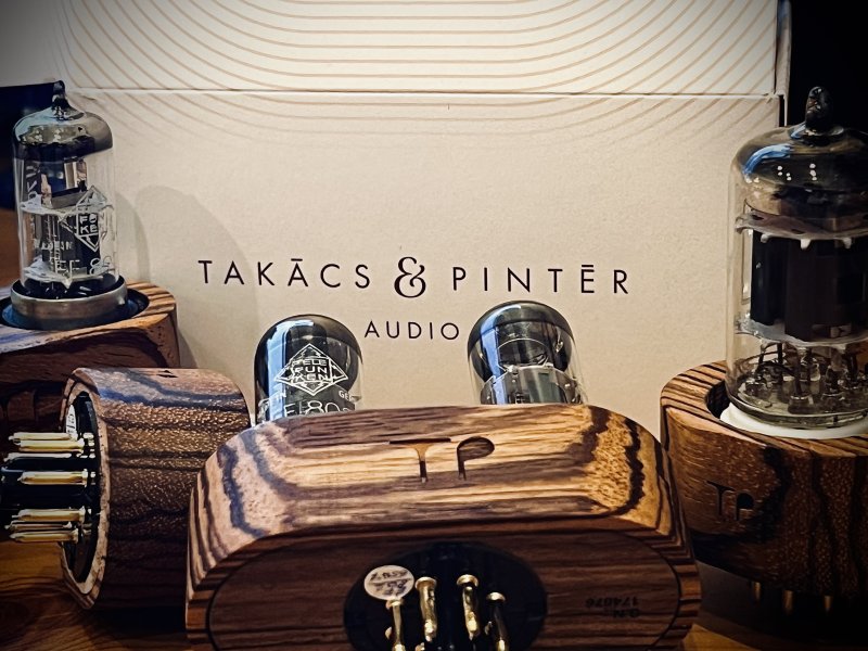

Burning in E55L pentodes and EF802 triodes for a new combo from the Hungarian wizard....
