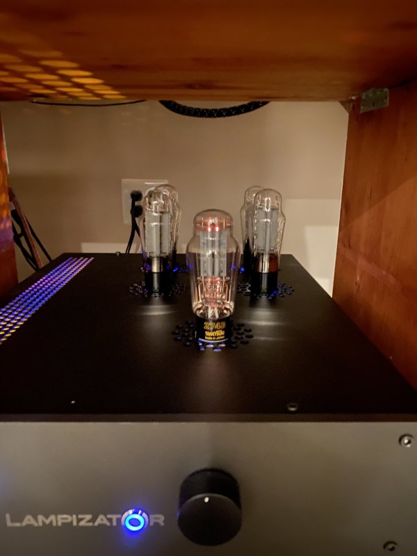

KR242s update
Around 200hrs now —opened up nicely to say the least.. This is still the most 3D/dimensional tube I have tried. Also now has the overall balance and midrange bloom I crave- plus dynamics. Did I say dynamics? This is a unique combination.. Color, more than a touch of warmth, it is all there as well.
You hear everything and at low volumes It doesn’t seem to close in. No bite whatsoever at higher volumes it just makes you want to turn it up more.
I would say at least the equal of the RK 242 if not better overall, and still breaking in.
Nice.
I have tried the USAF596 recti and Taka 274b- both excellent- but went back to
RK5u4G Lampi Anniversary.
Not sure if I can say there is a clear winner for recti, it will take more time to make that determination and it may just depend on mood.
I can say, however, that the 242 noise (max vol on analog input without signal) doesn’t seem to vary much with rectifier for me so it provides max flexibility in that regard.
