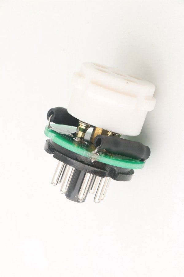

If one puts a rectifier tube in an adapter that uses 1 ohm resistor (s) into a two ohm one, what will happen — lower volume? I have two physically identical looking adapters that are unmarked and am trying to make sure I have them sorted without damaging anything.

Do you have a multimeter? Without knowing the properties of the circuit and the tube it hard to tell exactly (in number values). I would tend to believe that you could measure the output from the tube sockets both prior to and after placing the adapter. A little math would provide the drop in current/resistance.

It's a Golden Gate 2/3. I do have a multimeter and was trying to measure the resistors, however it's hard to get a stable placement leads and thus reading. The resistor leads and solder joints of the finished products look like the close end of the one in the photo.

Have you tried inserting the probes into the top of the socket directly? I have a TRP3- not a GG but my documentation states that on the rectifier input measurements should be able to be taken across pins 2 and 8. If you power up and pull the tube measure the ohms across those pins. Afterwards plug your adapter into the socket and measure again across those pins to determine the delta in Ohms.

Thanks. I'm not getting anything off pins 2 & 8. I tried the resistors underside solder connection again directly and was able to get 0.5 and 0.9 ohms. I know the 2004 is 0.5 and the 1064 is 1.0, so that should do it. This was more to store the adapter for possible future use, as I have another adapter that's better for the 2004.

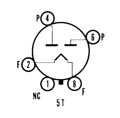

Whilst were on the subject, I have a pv200/600 rectifier which is a 4V tube. Its pin configuration means it plugs straight in. Any issue with running a 4V tube with no adapter/resistor? I think the socket is 5V?
I’ve looked for a data sheet on the tube as you’ve described it and come up with nothing. Do you have a data sheet for it? The design specs may shed some light on the operational range of the tube.
This is the PV200/600 pinout:

and here is the 5U4G pinout:
(sorry about the size difference). In the first case, the filament pins are separated by an anode pin, in the second case, not; so there's no way to plug the PV200/600 correctly into the dac's socket without an adapter.
(sorry about the size difference). In the first case, the filaments are separated by an anode, in the second case, not; so there's no way to plug the PV200/600 correctly into the dac's socket without an adapter.
OK thanks for the info. The diagrams dont mean much to me, as I dont know how to read them, but the message is clear!
