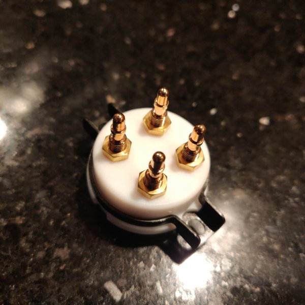

Here are picture of what can be used as Extenders and can be bought in France for double price:
eizz-4-pin-ptfe-valve-tube-socket-base-gold-plated-300b-2a3-811-274a-5u4g.jpgdown eizz-4-pin-ptfe-valve-tube-socket-base-gold-plated-300b-2a3-811-274a-5u4g.jpg
Norman I have already told you they won't work.
Look I have some. See below. The ones I have are real CMC sockets. They cannot be used as extenders!!!! I have already said why.
I am not saying anymore on this topic!!!!:)
Yours have the nuts on the pin that may block insertion. Look closely at my pictures.
Looks closely at yours. All underside pins are the SAME WIDTH. They are tube sockets not tube extenders Norman.
UX4 sockets have two fat pins and two thin pins so you orientate the tube correctly.
I cannot see how you can fail to accept this.
Also they have mounting brackets because they are sockets. Extenders don't need them.
Yours probably don't have the rings in the underside legs because they are copies of the CMC design.
GG1 uses CMC sockets. Maybe others too.
i know all this Justin. Chill. Really not trying to upset you, as you have been very helpful with this topic.
If the pins are small enuff to fit in the small holes, then I am GOLDEN. The only problem is if all pins are fat and wont go into the skinny holes and I dont think so from visual inspections. Old DHT tybes like real WE 101ds have 4 pins all the same size. Some vintage DHTs have short pins too. Vintage tubes can be all over the place.
In summary, it is quite possible to use other solutions that have not been blessed by the manufacturers. The real obstacle is the internal wiring that must confirm to UX4 and as these are 300b sockets...its for sure! In any case...its cheap to try.
How are you golden even if they all fit in? They'll be as loose as f#£k.
You will find all 4 pins are smaller than even the smallest holes. Unusable. Unless you solder them in and ruin your Lampi.
Curious.
Come on Norman. Just admit your wrong LOL.;)
You could be right...but I dont think so. We shall see and I will be honest with you when they arrive.
