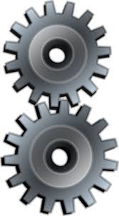

Imagine you have a two gear system like below:
images
Assume the top gear is perfect in every regard. Its teeth are all identical, its bearing perfect and the circumference, a perfect circle. And it rotates with zero variations in speed.
Now imagine the second gear being what we can build in real life. Its teeth have slight imperfections, it is a bit out of round, its bearing has variable friction so it slows and speeds up ever so slightly.
If I then start to rotate the first gear, the second will also rotate with it. But even though the first gear matches the idealized gear, the rotation as seen by the second gear has variations in it.
By the same token, the first gear can be your jitter free source but if it is not able to communicate its speed with zero fidelity loss, the final outcome is less than ideal.
In digital audio, the DAC must recreate the clock frequency that was used to digitize the samples. Unfortunately consumer audio systems are broken and rely on the source (the first gear) to tell it how to do that and that process, is not precise and subject to corruption.
