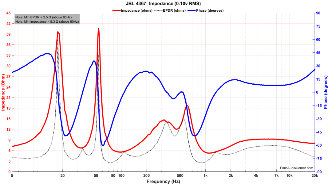

I would look for a solid state that you like KIS. Just be aware of the EPDR which dips to 2.5 ohms and 3 several points. From Erin's site
