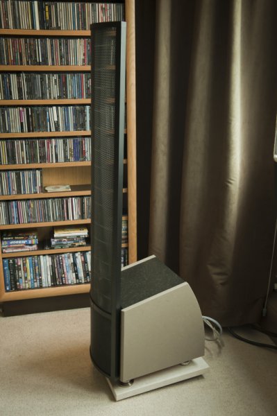

Well i may aswell start here though i'll do an intro in the new member section too.
ML user for 7 years now, currently using modified Spires, write up on ML owners forum, a few familiar names here too.. The Spires were good, but not quite great. I have over a two year period got them to sound really very good, possibly great? Removal of all the electronics, rebuild of the crossover with Clarity MR, Duelund resistors & Mundorf foil inductors, direct soldered the trafo to the panel, Clad the bass cab in Ceasarstone and granite, each speaker now weighs 52kg instead of original 26kg, and better planted for it, panel is very rigid now. Fitted Finite Elemente cerabases instead of spikes, all run from A PS Audio P10.
All driven by redbook source, MBL 1531 with Concert Fidelity DAC 040. As we are now UK distributor for CF, we use the 080 LSXv2 & ZL120V2SE mono power amps. The sound is sublime, so clean and pure, transparent, dynamic with real weight and punch when required. Music is varied but often Classical & Jazz dominate the playlist. I also own ASR Emitter2 exclusive, very nice amp indeed, but sadly no match for the Concert Fidelity in terms of transparency and definition, esp at the f extremes.

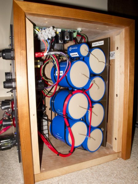

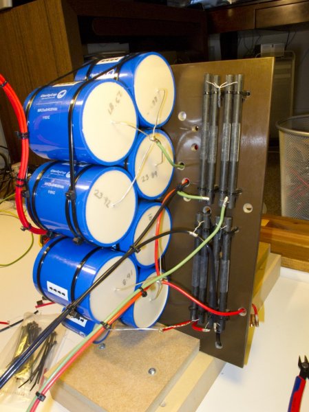

Been hearing a lot about the Clarity caps (some are actually inside my phono stage!). How did you come to select them for use in your xover? Did you prefer them to the Dueland caps?
Thank you Myles, It's good to be here, it's certainly one of the better forum's around in my opinion.
Re the capacitor choices, it is very difficult. The Spire crossover requires 2x 47uf, 1 x 33uf, 1 x 15uf, and a 2.2uf each channel. So that is a pretty heavy investment when looking at caps of the likes of Duelund, clarity etc. The cast were prohibitive, though i was very keen to learn about what they would let through. At over 7k, (GBP) it was not an option, as i'd have them built to order. The clarity MR came in at around 3.5k (GBP), which was still a chunk but i was ok with that, and over many months of reading and discussion, opted blind so to speak for the MR. The vsf was also an option, but knowledge gained from others led me to believe that the MR was sonically where i was hoping to be. Of course, it is impossible to try out others, so the order went in and after two months Clarity delivered. Tolerances were pretty accurate, and the caps were huge! Sound wise i have never regretted the choice, it does make a huge difference along with careful building and layout. I know Ack (Peter) has worked on his ML's too, we trade experiences over on MLO.
A few pics of the build..
Hi there! Finally you joined... you should post your structural changes too. Paul's work is MUCH better than the manufacturer's itself, and an inspiration. These mods catapult ML hybrids to the ~$30K range.
That's one heck of a beautifully built xover! So you guys personally removed and worked on the xover yourselves? In what areas did these caps make the biggest difference? ML just recently became available in the local market and the few times I've heard it I've been mightily impressed by the Montis. Is there a big performance gap between the Summit and the Montis?

Beautiful caps, I'm going to have to try that one day.
Hello Peter, good to hear from you again, your comments are always pleasing to read! I trust you are enjoying yours?
dafos, Yes, all work was carried out by the hands that type this! It's not solely the caps that make the difference, but i expect they are the major contributor to the improvements. Transparency and dynamics were key areas of improvement, image placement is i'm sure a side effect of the transparency gains, but there is a marked definition to the palpability of the sound. Re Montis vs Summit, (I presume you mean Summit x), I have not spent enough time comparing the two, and each time i have heard them it has been in an unfamiliar system and room. Saying that, i did not think the Summit x was brining more music into the room, they are both good. If i were looking at either, i'd probably opt for the Montis and make a few tweaks like feet, add bass cab granite etc.

Yes, we've all done the work ourselves. All these mods make a huge difference up and down the entire spectrum, nothing short of a major component upgrade. With mine for example, I was unable to properly reproduce organ before; it's got all its glory now with a major wow factor, save for sheer size. They remove layers and layers of veil, distortion and noise; add significant speed, scale and dynamics, and you can now easily hear the _sinusoidal_ decay of notes (which is, in fact, now also much longer in duration), and that adds to the realism; make for really fast, tight and articulate bass; and most of all... this is how you actually properly blend the woofers with the panel in terms of speed and articulation. My speakers are more difficult to work with in that region, because they include both an 8" and 10" woofer operating in different and overlapping passbands (see Wilson Alexia), but I feel I got it right; and like the Prodigy (and the Alexia), they have non-parallel walls except the sides. All in all, I have spent well over 300 hours on these crossover and structural mods and listening tests, but really worth it and fun.

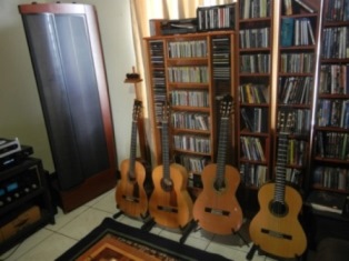

babies.JPG Hola... here is a little trick that I am using for harmonic texture and to have the musical notes singing with the right time decay. I have my guitars tuned at different musical notes, and when a piano note is play, as an example, due to the sympathetic resonance, the strings of the guitars starts to sing along with those notes, adding to my sound a harmonic richness and texture to the sound of any instrument that it is tuned at 440Hz=A musical note. The strings resonate and add echoes at micro level, that your brain picks them up, and my room is filled with more natural sound. The piano is breath taking. The strings are more strings...I am adding harmonics. If you try to listen to them at one meter away from the guitars, you perceive them, now I am enjoying much more my music. I am re-discovering things that I had never listened before...yes, I had made a lot of changes in my system...and I am in heaven right now. Happy listening!
