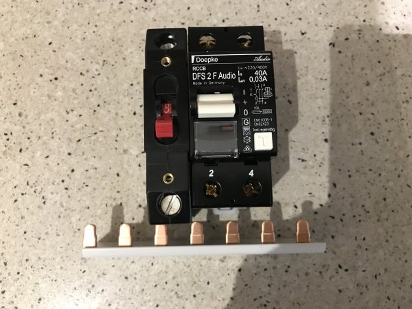

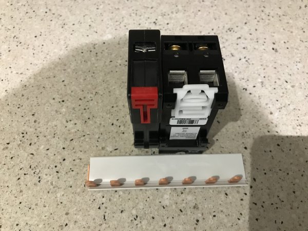

Finally got around to installing 4 x Gigawatt G-16a MCB and one Doepke DFS-2 Audio RCCB, however the job was not as easy as simply replacing like for like in the Hagar consumer unit.
Thankfully the Doepke does meet the same size and shape of the Hagar MCB, with a little adjustment to the length of the exposed tails due to the entries having less depth for the bare wire. Perfect clamping mechanism from the Germans.
The Gigawatt unfortunately have their cable entry points further forward and so do not align with the existing copper busbar or the Doepke cable entry. This necessitated star linking to the Doepke with some spare Oyaide copper cable. The cable entries also have that awful centre screw like Furutech use which I dislike. I presume they expect people to use a spade lug. They are also a touch wider than the Hagar MCBs and fit very awkwardly into my consumer unit and don’t allow the cover to be put back In place. In my music room that doesn’t matter but may invalidate your home insurance cover. You have been warned.

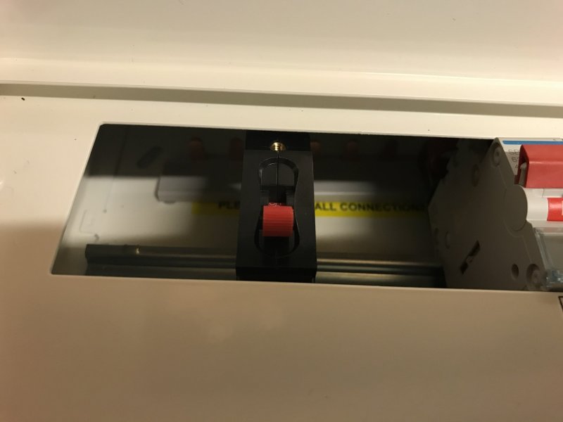

Here’s my current mains setup which has evolved over the years. With hindsight it may have been easier (better?) to have purchased something like a Gigawatt PC-4 Evo and be done.
Dedicated HAGAR Consumer unit from Henley block using 25mm tails
DOEPKE DFS2 AUDIO RCCB plus 4 x GIGAWATT g-c16a MCBs

Blue58,
Are you able to post some photos of your installation please?
This is currently (no pun intended) of interest to me, having looked at the Kemp Electronics website and been suitably tempted.
I have some Henley blocks, tails and a MEM consumer unit with 32A RCBO's from my upgraded installation in my last house. The mains quality is very good in my current 'new-build' home, so I haven't bothered with the mains (but you know how it is!).

Blue58,
A bit of a botched job I’m afraid because my panel would only accept 4 breakers max, of Hagar brand, and as the Gigawatt are slightly wider, 0.5mm, the fourth would not clip onto the rail. I had to make adjustments to the cover to enclose all the wiring. And, as stated before, the busbar does not line up so I star wired the 4 breakers into the Doepke.
i think you would be fine with your MEM box if it accepts more than say 6 breakers.
