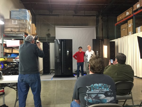

Thanks for posting these fabulous pics Wilson! Looks like quite a turnout
