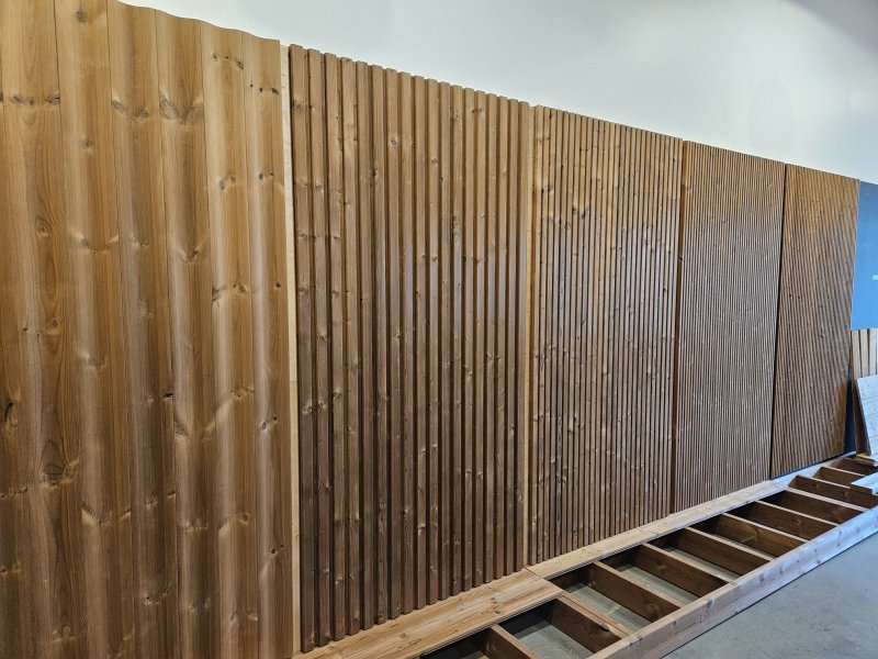

Looking at flooring today I found this wood for walls. This is going to find a place in my listening room. Maybe the ceiling.
The picture is a few different styles. About $6 a sqft. Very affordable.

There’s also an acoustic variant available that may be better though more expensive. I’m sure there are US suppliers.
https://www.acupanel.co.uk/products/acoustic-slat-wood-panels
These panels have a felt layer behind them and are designed to facilitate conversation - not music reproduction. GIK offers a variation on this architectural paneling with different thicknesses of their absorber material behind it - FYI: https://www.gikacoustics.com/?s=flatfusor&post_type=product
