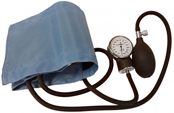

Five pounds will get you a manual blood pressure meter in any chinese shop - and it is enough for the purpose. Remember that 1 psi is 51.7mm and you can get an air T connector and tubing in any pet fish shop.
The unused air pad and pump can be very useful to built a cheap pneaumatic rack. I have also used it to start lifting heavy objects when I can't insert my fingers under them! :)a1.jpg
