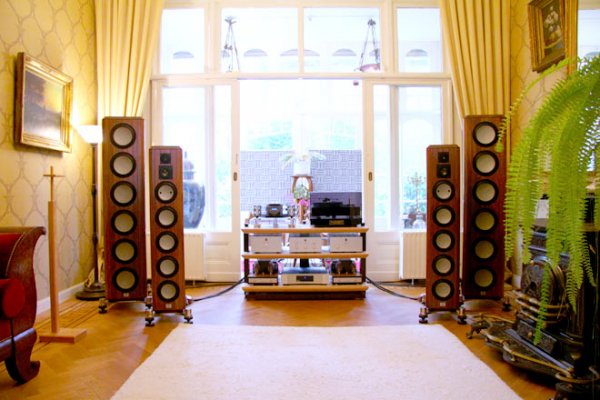

Does this pic happen to have any resemblance of the two doors ;)
Ah, you are clever .... but actually these are the sliding doors towards the conservatory, not those in the 'room en suite'. Of the items you can see on the picture quite a few were sold, such as inter alia the Metronome kalista reference cd-transport and the Kondo dac.

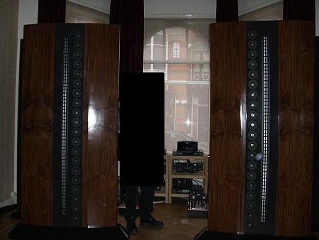

Ya I knew, I was just playing with ya :D I'm sure this looks familiar - blacked out image just for you but you are already on the net ;)
Being a recent owner of IRS V's I have my memories along with folder with any related pics with either Infinity or Genesis related speaker set-ups - always peaks my interest seeing set-ups and with what components have been chosen as Gary knows.
I'm sure Gary won't mind as it's all in all apart of Genesis speakers. I have never heard a pair set-up "wings" as close together as in your pic's with the woofer towers in behind - never mind with the gorgeous Kondo gear driving - would really enjoy hearing. My room was approx. 30 ft wide with 15 ft ceiling and approx. 47 ft long so I was able to get some pretty amazing sound but moved and lost that room. Tried setting up in a much smaller room similar to the width you have but did not have the ceiling height nor length you currently have, I was not satisfied over all - kept them for a while but eventually sold them :(
