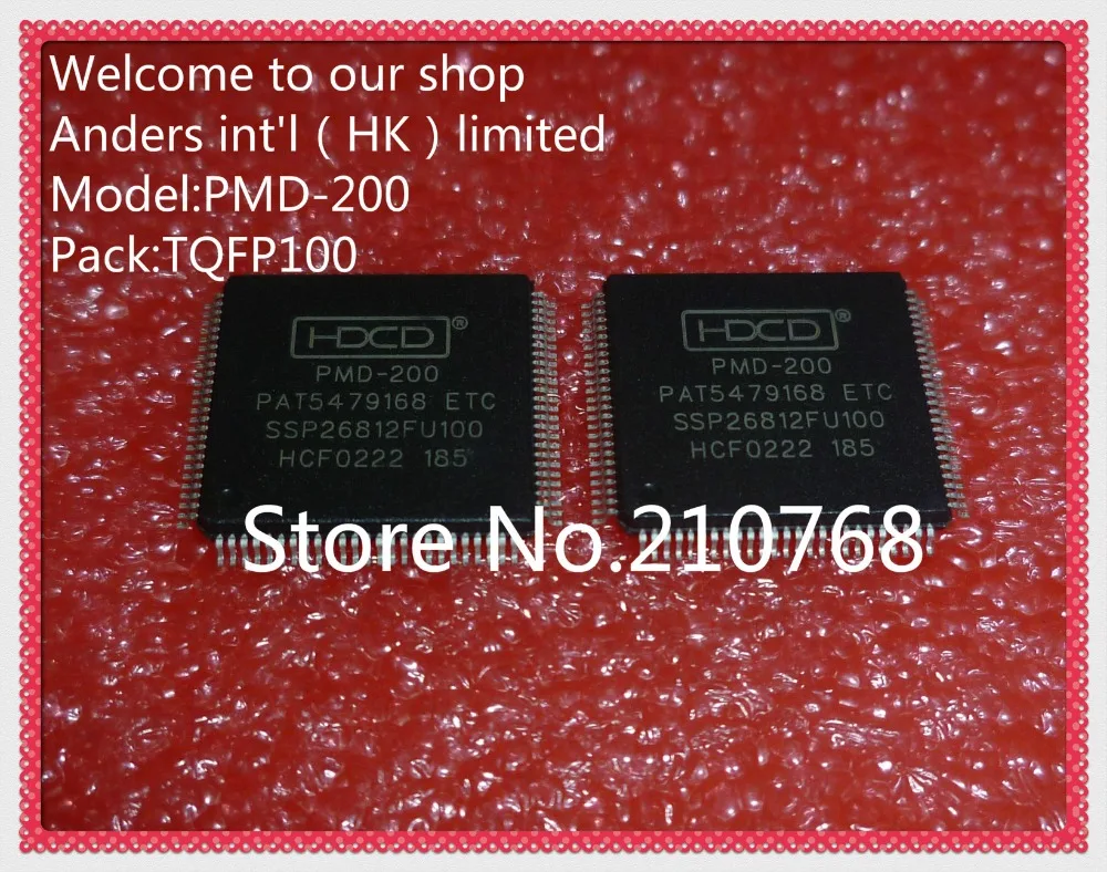

All my HDCD players have the HDCD decoder/filter chip inside. ...The one I posted a picture of not long ago. And it was replaced by the PMD-200 later on.
http://www.hifimaker.com/documents/pmd200.pdf
Both the PMD-100 and PMD-200 are fairly large rectangle (PMD-100) and square (PMD-200) ICs. You can't miss them on the circuit board.
The PMD-100 has 28 pins.
The PMD-200 has 100 pins.
