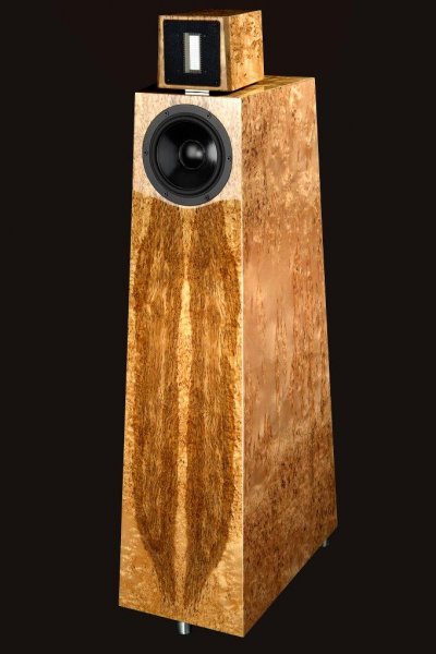

Panzerholz is used in all Kaiser speaker models. I have always thought that the Kaiser speakers were VERY natural sounding speakers compared to others -

Kaiser uses Panzerholtz (or "Tankwood") in their speaker cabinets and baffles (the new Furioso series). So does Artesania and Kroma in their racks and speaker stand platforms.
Kroma uses thermoplastic screws rather than metal for the drivers as well to avoid the ringing mentioned earlier in this thread. These are magnificent speakers that truly conveys the essence of the music in a beautiful and highly engaging way.
