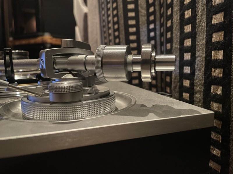

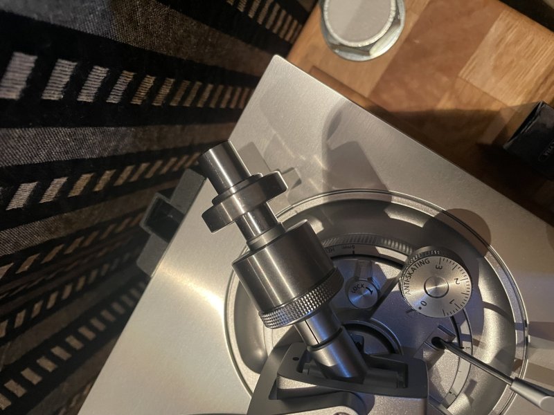

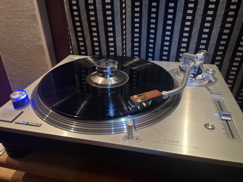

Now the PP-2000 is back on the SL-1200G again, trying to max it out to see if I really can make it sing.
By making the overall weight of the headshell heavier, and balance it all up with another additional counterweight. The overall total mass of the tonearm has helped me in the past to get the sound I want from this turntable.
Also I have raised the VTA slightly over perpendicular to the platter/vinyl surface. I noticed when I played on the Ascona, that things opened up a little bit more, so I might as well try it on the SL-1200G too.

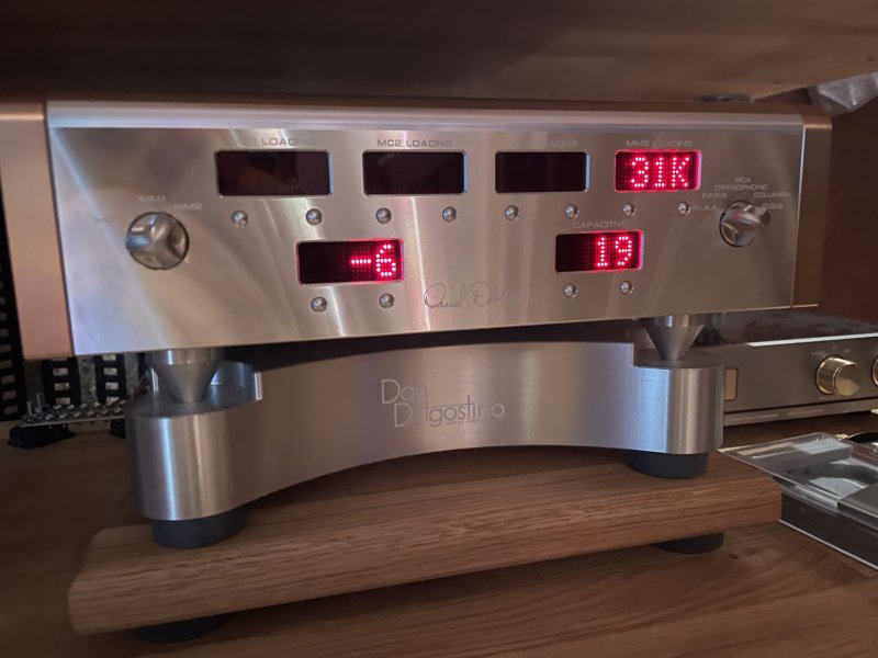

Load is set to 31K Ohm and the capacitance is down to 19, the lowest setting on the D’Agostino Momentum phonostage. Gain is set to 44dB on the Momentum and 23dB on the AirTight SUT, so 67dB gain in total.
As for right now, I have Dire Straits - Brothers In Arms going on the SL-1200G, the song ”So Far Away” is spinning and I can already hear a lot more calm after boosting up and maxing out the tonearm mass. More calm, quieter background, more of everything, so I guess it was all worth this effort.

about the same cartridge/headshell combo weight as the Koetsu Blue Lace which the PP-2000 is replacing, I have decided to stay with the same bias force / or antiskate force as the Koetsu setup.
I’m sure you already knew this, but cartridge/headshell weight is irrelevant to anti-skating. VTF is the determining factor. If both cartridges have the same VTF, then it’s fine.

Phasemation PP-2000 conclusion:
So yesterday I boosted up the SL-1200G tonearm, made it overall a bit heavier and re-fitted the PP-2000 cartridge, to see if I really could get some more out of the SL-1200G turntable. It seems I really nailed the alignment cus last evening it sounded so good I couldn’t stop playing.
To be honest, it is now rather close in prestanda to my much more sophisticated Ascona Neo turntable, which has been my goal all along. All it took was some trix and fix and go a bit out side the box.
So right now I’m just enjoying the remarkable sound of this beautiful PP-2000 cartridge. In my opinion it is now delivering the whole spectrum of what I think is possible in my system. It delivers everything I want AND MORE.
This cartridge has brought some new fresh air in to my system and more than just once or twice, it has made me dropped my jaw to the floor due to the amazing sound reproduction. In my opinion this cartridge has it all while not being over analytical. The balance between the bass, midrange and the treble is just perfect. If there is something that really sets this cart apart from my three other top cartridges it is the midrange. The midrange of this cartridge is nothing short of phenomenal. As I have stated earlier, this midrange really melted my knees… made me smile and scream out loud - well not very often that happens, but it is that good!
Well - my test is pretty much done. I have now a very strong candidate for my SL-1200G, as it now performs as a very strong compliment to my Ascona Neo. I could without a doubt live with this cartridge for a long time if I decide to invest and I can for sure recommend it for anyone interested in investing in a new all around sounding high end mid-priced phono cartridge.
