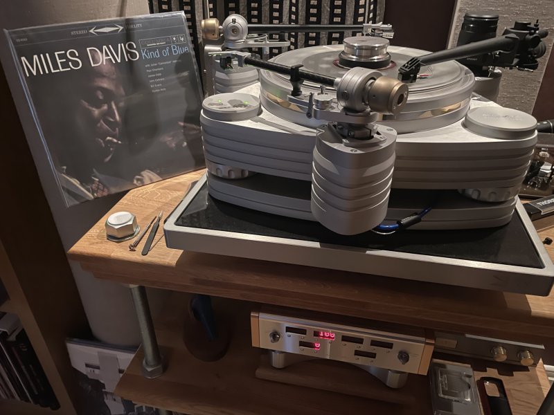

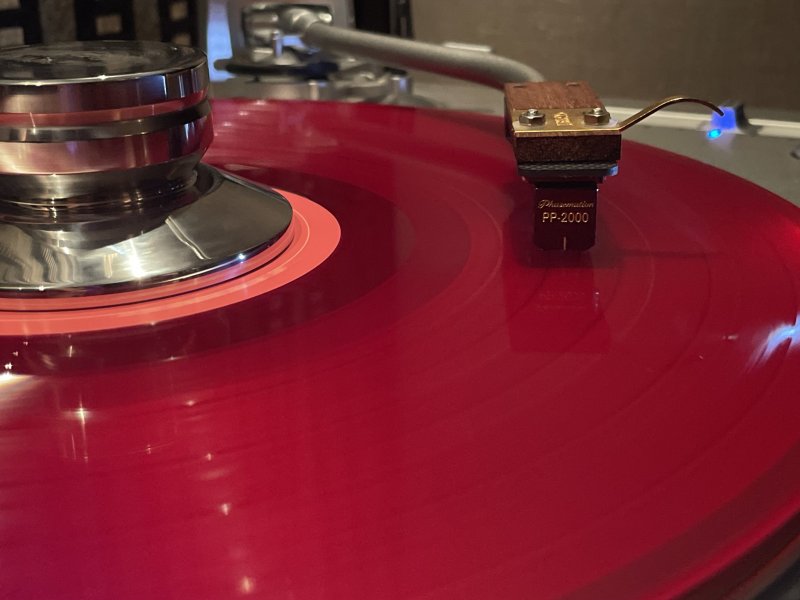

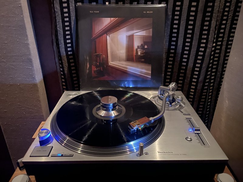

So yesterday I had the opportunity to receive the Phasemation PP-2000 cartridge for testing at home, to see how it match up with my Technics SL-1200G turntable. I feel it is time to have something that matches up for my other carts on the bigger, more sophisticated Ascona Neo turntable from Acoustic Signature.
So late yesterday evening I was able to roughly mount and line up the PP-2000 in my Jelco HS-30 headshell. Going through my AirTight ATH-2 Reference SUT, at 23db and into the D’Agostino Momentum Phonostage at 44 dB I get a total gain of 67dB which is more than enough for a good level output.
Fine adjustments is ofcourse needed for the next coming days, but I did get a first impression listening to it last night, and I must say I was blown away by the midrange right away, which to me in my system sounded really really good, very smooth, relaxed and very airy. Bass was fast, very tight and very balanced. Not too much in terms of depth or overwhelming bass, but just very clean tight fast bass.
Treble on the other hand did raise a bit of concern at this first round of listening. I felt it was little bit bright… but this also has to do with my system was stone cold as it had been shut off for some time. After a few hours, the brightness had vanished quite a bit and was getting smoother by the hour. Hopefully it will continue this way while testing over the weekend and coming weeks.
To this must be add, that the cartridge is not brand new, but broken in by the dealer who’s been playing it for some time. Btw, the dealer is the nicest guy ever, just so you know. Anyway, should this remain, I certainly have a bunch of aces in my back pocket to use, try to overcome the slight brightness of this cartridge.
All and all, as a first impression, I am quite happy with what I heard, and regarding the tracking and behavior, it tracks great. The first rough setup was rather simple if compared to the Koetsu cartridges where you’re almost ready to strangle someone standing close, due to the difficulty to see the cantilever underneath the Koetsu cartridge body. The alignment of the PP-2000 was a walk in the park in comparison.
So not much more to say at this point. More will follow as the test goes on. Enjoy!
/Jk

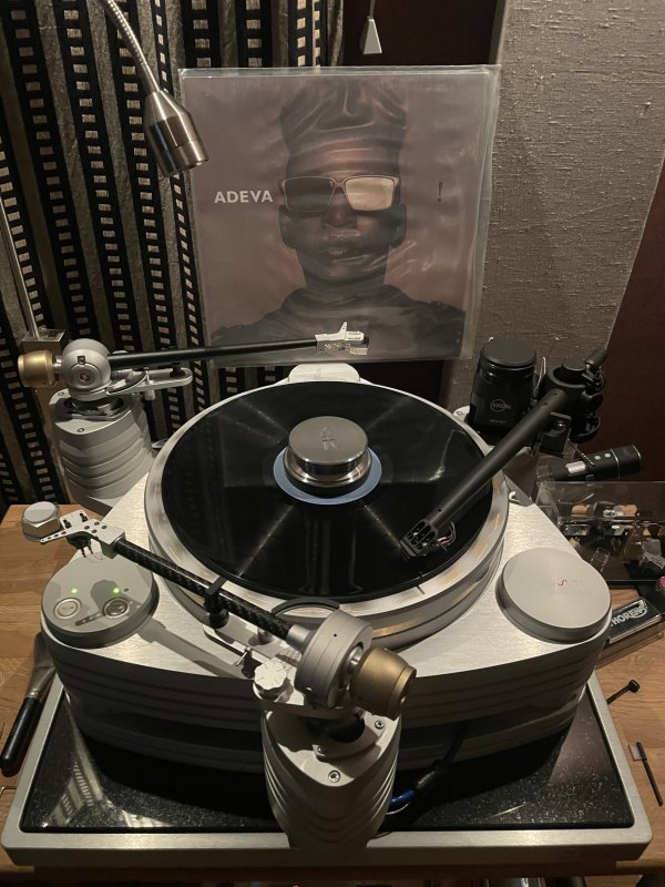

So back in sweetspot once again, just playing around with the PP-2000 cartridge. It seems that the upper end has calm down quite a bit since start up of the system the other day. Early Saturday morning here, and first out on the SL-1200G is Nils Frahm - All Melody, from 2018. The sound is really really nice. Very balanced sound overall, and I don’t feel any stress in the treble at this point. The vertical tracking force (VTF) is set to 1,85grams, which in the middle of recommended (1,7-2,0g) from the manufacturer.
Due to relatively high combined weight of the cartridge/headshell combo, I use my specially made external super-counterweight at the back of the tonearm. At 18,5 grams it helps balance up the tonearm to accommodate heavier cart/headshell combos, which has worked out very well here. Also due to it’s compact design, there is no trouble to put the cover on as well - even playing with cover closed works just fine.
Tonearm is set flat/horizontal to the record surface, which in this case means I had to lower the VTA tower to it’s minimum, which is fine as long as the arm is horizontal. Ofcourse there are thinner and thicker vinyls, but that is a minor issue and doesn’t make that much of a difference in SQ in my system. I would say it sounds equally as good.

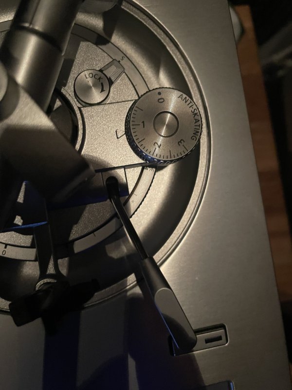

The bias force or the Antiskate if you will, is set just over 1,1 on the knob-scale. This is set by using the Wally Skater by WallyTools (thank you J.R.), but not only that… It is visually and sonically fine adjusted by me, looking at the behavior of the cantilever as it tracks down the grooves, and at the same time fine adjusted the bias force untill the cantilever follows the cartridge body perfectly in a straight line, without any force from either left or right side. I have found this technique to be very effective.
As for right now it is a big difference in SQ since the start up the other day. Now everything is up in temperature and is sounding really good. I will play around with more vinyls, more different music styles before making any more changes at this point, to see how the PP-2000 behaves.
More will follow… Enjoy ;) !
/ Jk

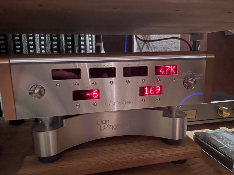

Now … prior to the PP-2000, the SL-1200G has been hosting the Nagaoka MP-300 moving iron cartridge, with an output of 3mV. That has not been any problem as my four input D’Agostino phonostage has two MC and two MM inputs. Well the two MC inputs are already occupied by the AirTight Opus-1 and the Koetsu Blue Lace, which leave me to having two MM inputs for overs.
Now, the first MM is used for my 0,2mV Ortofon MC Diamond, which is going through the AirTight ATH-2 Reference SUT at 23dB gain and onto the D’Agostino phonostage where it is boosted with another 45dB, and optimized with the right output gain to match the other cartridges output, and some capacitance at 75uf. Most say capacitance have no effect on a MC cartridge, but when going through the SUT is has, and actually makes a difference.
So to accommodate the PP-2000 cartridge from the so called forth arm or the SL-1200G turntable, I have had to make a special to be able for some individual settings for this cartridge. As I have a pretty long cable run from the SL-1200G to the SUT and phonostage it has given me some sleepless nights, but now when everything is hocked up and running, it seems to work just fine. So the cable run is about 6 meters or about 19,6 feet.
Believe it or not, but I use a very simple rather cheap 2 x RCA to RCA, quite thick unshielded copper cable, and a regular 2,5mm² inwall lamp wire (copper) for the ground, as a tonearm cable from the SL-1200G to the SUT. And believe it or not AGAIN - It works just perfectly!
I had some issues with hum and buzz in the beginning, but it is all gone now due to some trix and fix at the grounding busbars next to the phonostage. So the AirTight SUT has three different inputs, but only one output. It has a bypass for MM cartridges and two different gains at 23dB and 29dB. Well a lot of features, and do suit me very well as I like to have possibilities for changes.
One thought of mine at first, was to use the same ONE output from the SUT for both the MC Diamond and the PP-2000, but this was a bit of concern due to the different output of the carts, and the very different cable runs. This had me wondering about Y-connecters on the output of the AirTight SUT.
Well if you wanna know something one is got to try.. right..!? So now I run two similar outputs from the SUT, into two separate MM inputs on the phonostage, each with different optimizing settings and parameters, and got to tell you guys - it works really really good.
Now I could optimize the cables, both from the SL-1200G turntable, and between the SUT and phonostage, but remember I am in a test phase to see what works and what doesn’t. Optimizing is for a later stage. Actually to be honest, I don’t know how much better it can be at this point and if so, is it really worth it, as it is very good as it is now?!
Finally I show some pictures behind the SUT and the phonostage where the magic happens… Enjoy ;) !

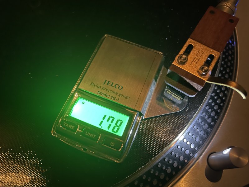

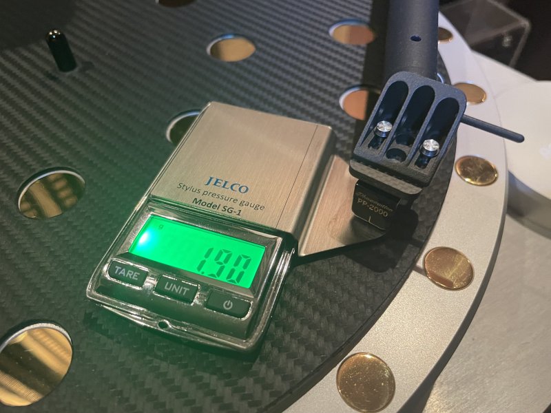

So for the last two days I’ve been playing the PP-2000 set to a vertical tracking force of 1,85 grams. Everything has really been smooth so far, but for a change I would like to hear this jewel with a bit more VTF to see what happens.
As I was checking the current status I could see that the VTF had been lowered by 0,7 grams for some reasons. The current reading was showing 1,78 grams, which is within range, though on the lower side. I think of boosting up the VTF to 1,90 grams to see if I can gain little more weight to the sound as well.
At 1,90 grams set I did double check the bias force or the Antiskate if you will. It will remain at just over 1,1 at this point. No need for change just yet, as the cantilever really behaves well in the grooves.
/ Jk

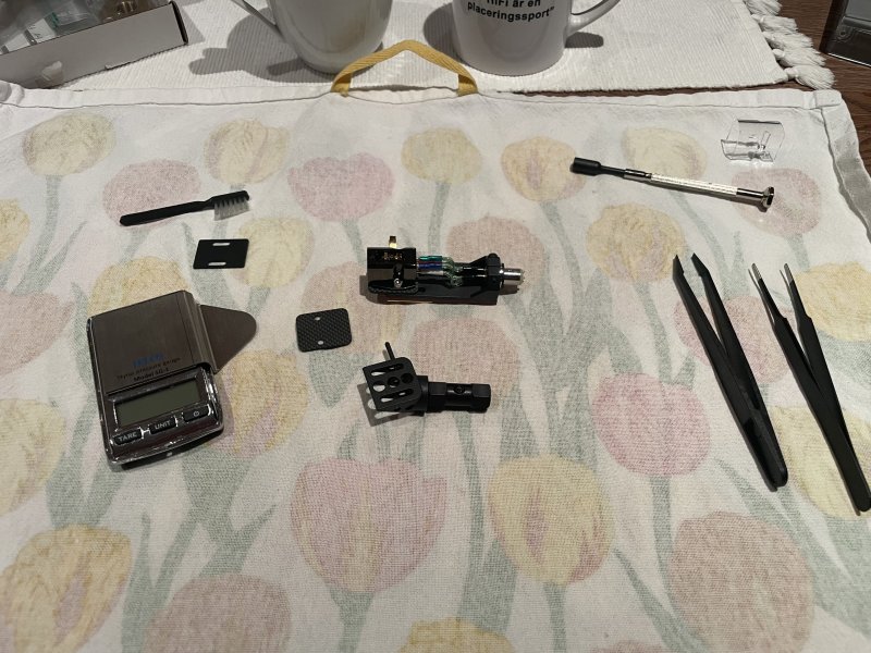

So this evening I took down the PP-2000 from the Technics SL-1200G and the Jelco HS-30 headshell and swapped it over to my spare Kuzma headshell for the Kuzma 4-Point 11” tonearm, sitting on the Acoustic Signature Ascona Neo. Preparing for the weekend, I will probably mount and align the PP-2000 on to the Ascona Neo on Saturday morning.
Until then… here is a few pics from the swap shop .. Enjoy :D !
/ Jk
/ Jk

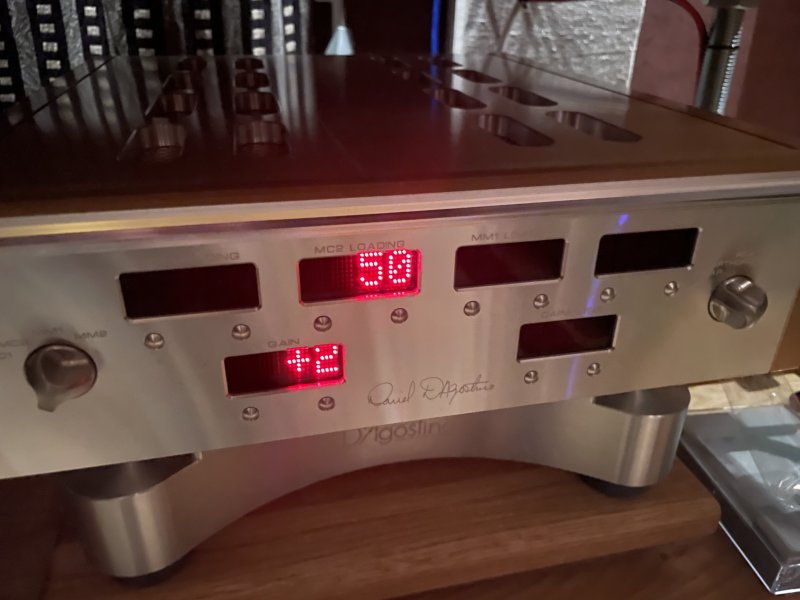

As I sat it up I had the gain set to the same as my Koetsu Blue Lace (72dB), but realized that I had to lower it to 70dB to match the output of my two other cartridges. Also as the system now is up to temperature, I had to change the load from 50 to 100 Ohms. Not a huge difference in SQ, but still enough to wanna stick with 100 Ohms.
